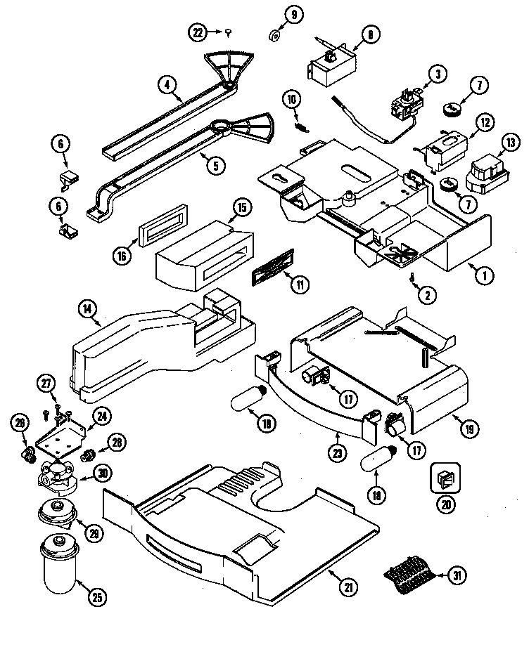

The FAQs have led me to the liklihood that I need to (first) check the Defrost Timer, which should be somewhere in the FF compartment.  I know what the part looks like, but I can't find where it's hiding in my MSD2454FRQ.  I have pulled out all the drawers and I removed the cover at the top, over the bulbs, etc.  Any thoughts on what I may have missed?  Hurry, my beer, it warms! Thanks!

Crap!  That means I have more things to remove before I can get to it.  Sneaky ninja Defrost Timer!  Thanks, Reg.

Whoa  there  big fella....................git yerself a mirror and look up in the right front  area of the control console..........look for a small round hole, it is there to stick your 'stubby' screwdriver into and 'turn'...................Clock wise until you hear the 'click'........... go slow as not to blast right thru the defrost cycle.............................

Thanks for the tip, '51.   The heater functioned after I rotated the little knob to the click, getting up above 61 F.  After 20 minutes the compressor came back on and everything cooled back down,  I guess that means the Defrost Timer was shot and I ordered the replacement.  That means I will still have to remove every other thing in Reg's diagram to get down to Item # 13, but at least I didn't have to do that, just to test the Timer.  Thanks, folks!

UPDATE!
CTG51 was smelling the correct rat.  Yeah, I've already ordered the replacement timer, but that doesn't appear to be the problem.  I masked the real symptoms by the order in which I did things.
1) Cleaned the condensor coils.
2)Turned the fridge/freezer off.
3) Emptied the freezer and removed the panels covering the evaporator; found the evaporator was frozen up.
4) Manually defrosted with a blow dryer.
5) Couldn't find the dang Ninja Timer, fridge still off, but freezer defrosted.
6) Eventually found the Timer, then unplugged the unit per Samurai's instructions, before messing with the Timer.  Manually advanced Timer to the CLICK, then got out my temperature gun and shot the Heater Wires.  Got a reading of @ 60F, so I assumed the Heater Wires were functioning.
7) The Timer turned everything back onto normal.
So, I read around 30 F on the evaporator coils, but 60 F on the heater wires, on a unit that had been unplugged while I messed with the Timer.  Re-doing the test this morning, neither the Evaporator nor the Heater Wires ever got up over 30 F during the defrost cycle,  This is probably because yesterday I had a defrosted unit which had been unplugged for a bit, so the heater wires were reflecting more of the air temperature in the empty freezer with the door open and no ice on the evaporator coils (therefore, 60 F).  Today I did it without unplugging, without manually defrosting, and the wires more closely reflected the temperature of the ice on the coils!
It's gotta be the dang Heater Wires, not the Timer!  So, now I gotta order the wires and return the replacement timer.

In step 6)   When put into 'forced defrost' the bi-metal was still open..............The defrost circuit was 'open'............What are the items you call 'heater wires'??........The wires that connect to the heater ( small round metal looking thingy)  should not get hot, just the heater itself...............When the freezer  has been down to '0' degs for about an hour ,( 30` on the evaporator ???)  check the continuity of the defrost terminator ( bi-metal )........................Try this, with the unit operating for over 8 hours,  ( 8 hour timer ) remove the evaporator panel, put unit into forced defrost, does the heater operate??............... it will be a dull red to a bit brighter red color and it will be hot....   Could still be the timer  ( p/n 68233-2   65 clam$ on the Shell-O-Meter) as more info is extracted.................. ( Heater assy. p/n 61003120 just for a  defrost terminator, at  about 41 clam$...................I have seen bi-metals go for 60 clam$..) ...
