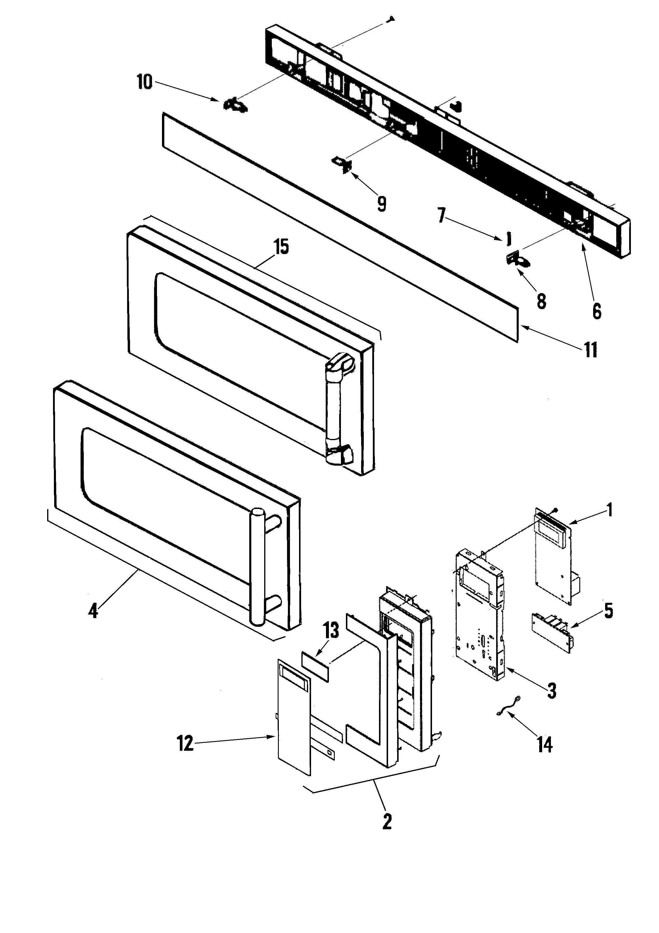

Looking at your diagram, that is a debacle of a vent design. I've never seen a microwave vent upwards. Jackass engineering.
I hadn't clicked on your thumbnail photo,
I just went right to Frigidaire's parts manual, and on-line retailers..
but they didn't show that angle.. :woot:
My SS Jenn-Air (Samsung) OTR has a front vent "flap" #11 that opens (top outward) when used
although, the Microwave case actually sticks out from my wood cabinets about 3"
Jenn-Air JMV9169BAS
