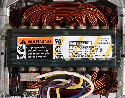

You sure the replacement Capacitor was the same MFD rating ?    I recall some errors with parts listings on some models, would bring up a different valued Cap.
Hey, Brutha, can you spare a dime for a cuppa joe ? http://web.me.com/zenzoidman/kdog/
Le Chien Rouge
#11 RegUS_PatOff
  • 30,190 posts
Posted 11 January 2013 - 11:25 PM
The manufacturer has replaced part # 8572717
with this item, part # 482156
189-227 MFD 125VAC
http://www.repaircli...sp?R=154&N=2859

Posted 12 January 2013 - 11:20 AM
  The original motor (part no. 8528158) for this washer calls for a 189-227mfd capacitor.
Eric
#15 RegUS_PatOff
  • 30,190 posts
Posted 12 January 2013 - 12:37 PM
If it's the original Motor
#16 fairbank56
fairbank56
    Sōhei
  • 141 posts
Posted 12 January 2013 - 06:06 PM
  Even the "correct" replacement motor uses this same capacitor. Of course, anything is possible, so the OP needs to check the motor label for the proper size capacitor.
