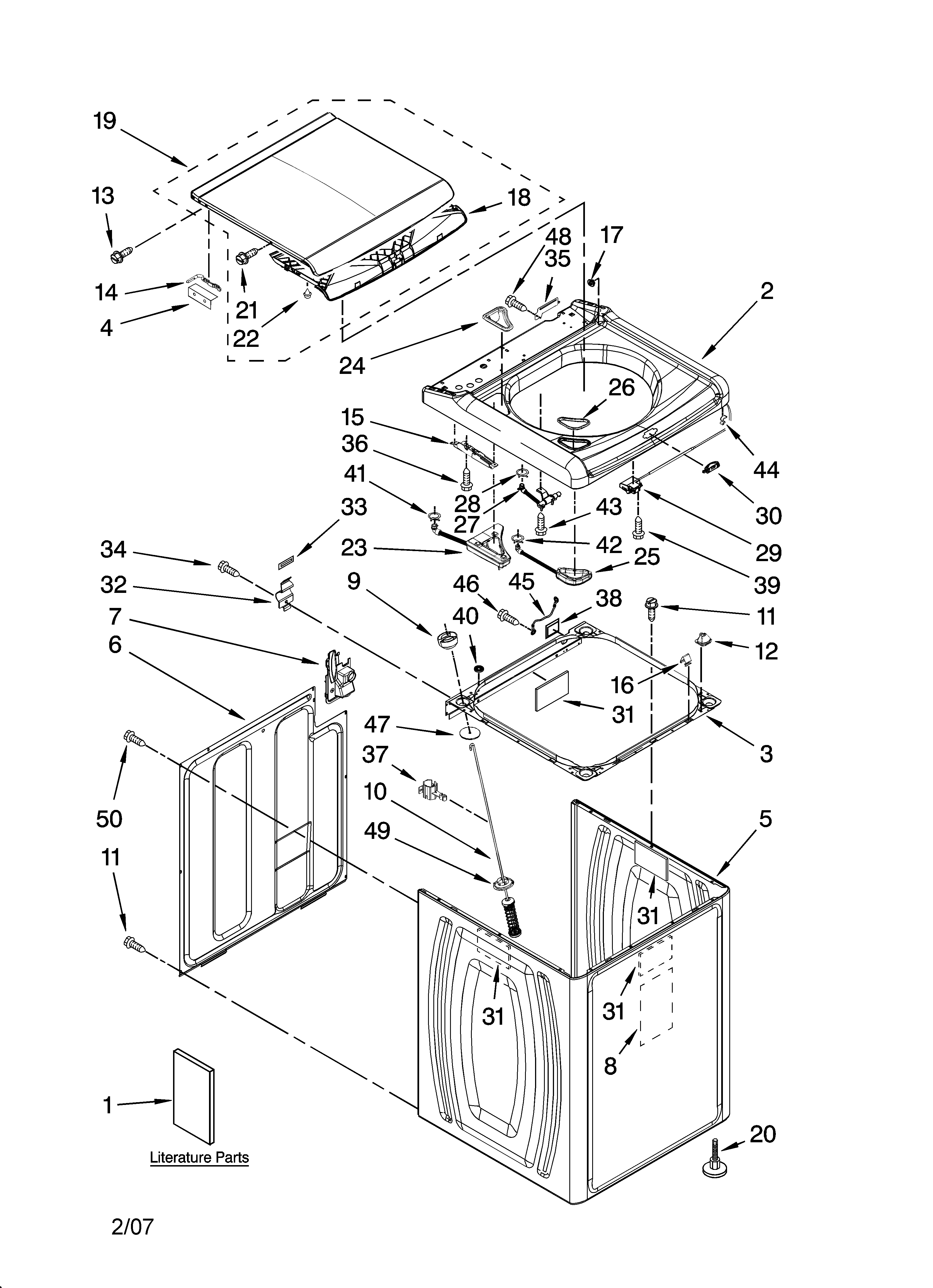

Edit: more research and now I'm more confused From the diagram at Sears the part number I need is 8563872, which is the one that is $70 including shipping:
<a href="http://parts.sears.c...563872/0026/110">http://parts.sears.c...563872/0026/110</a><br />
Searching on that number at RepairClnic yields: <a href="http://www.repaircli...63872&#38;nbsp;">http://www.repaircli...tNumber=8563872</a> in which we learn that "The manufacturer has replaced part number 8563872 with this item, part number W10161863" A more reasonable $35 but out of stock. However this part does not come up when looking at parts for this model number.
Referencing that number back to Sears, however, gets you to: <a href="http://parts.sears.c...8;amp;pop=flush">http://parts.sears.c...8;amp;pop=flush</a> wherein a "dispenser"  can be shipped right away for $31. -- I also see this part number at some other parts sites* for as little as $21 shipped. &nbsp; Not that I expect appliance parts pricing to make any sense but are these really the same parts?

#10 RegUS_PatOff
  • 30,708 posts
Posted 06 February 2013 - 05:17 PM
which Dispenser ?
# 23  OR  # 25 ?
#11 jgm
jgm
  • 19 posts
Posted 06 February 2013 - 10:02 PM
which Dispenser ?
# 23  OR  # 25 ?
23.  It's the bleach cup.  The hose is glued on to the cup.  Was hoping to peel it off and clamp a rubber hose as a temporary fix, but it's welded good.
