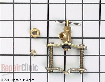

... of course there is a chance low water pressure on the supply line is so low the valve did not close properly
yes, may be caused if using a "self-piercing" saddle Valve ..
better to use the "drill type" saddle Valve
This saddle valve kit isn't self-piercing, it doesn't have a sharp, pointed "pin"
You'd need a drill bit to make the hole in the copper pipe.
(could be installed in the same location)
http://www.repaircli...rtDetail/584723
Water-Supply-Saddle-Valve-4378392-005584

So it sounds like a water valve is a given.  Will also need to replace the piercing tap.

If a bad saddle valve is preventing normal water pressure,
the Water Valve may not close completely

Well that was fun.... bottom floor of a retailer... no one knew where the water shut off was.... Eventually the manager shut off the water to the whole building.  I pointed out to him that he'd just disabled his sprinkler system and asked if he'd contacted the fire department, as some of these systems will automatically alert if the water pressure drops... He ran out of the room after I said that.
Takes a while for a three story building to drop pressure even with all the water shut off, so during that time I replaced the water valve and cleared out an ice blockage in the fill cup.
Once I had the new saddle tap on (old self-piercing valve dissolved in my hands as I took it apart), flow into the unit was normal.  Hopefully that's the last we'll hear of it.
