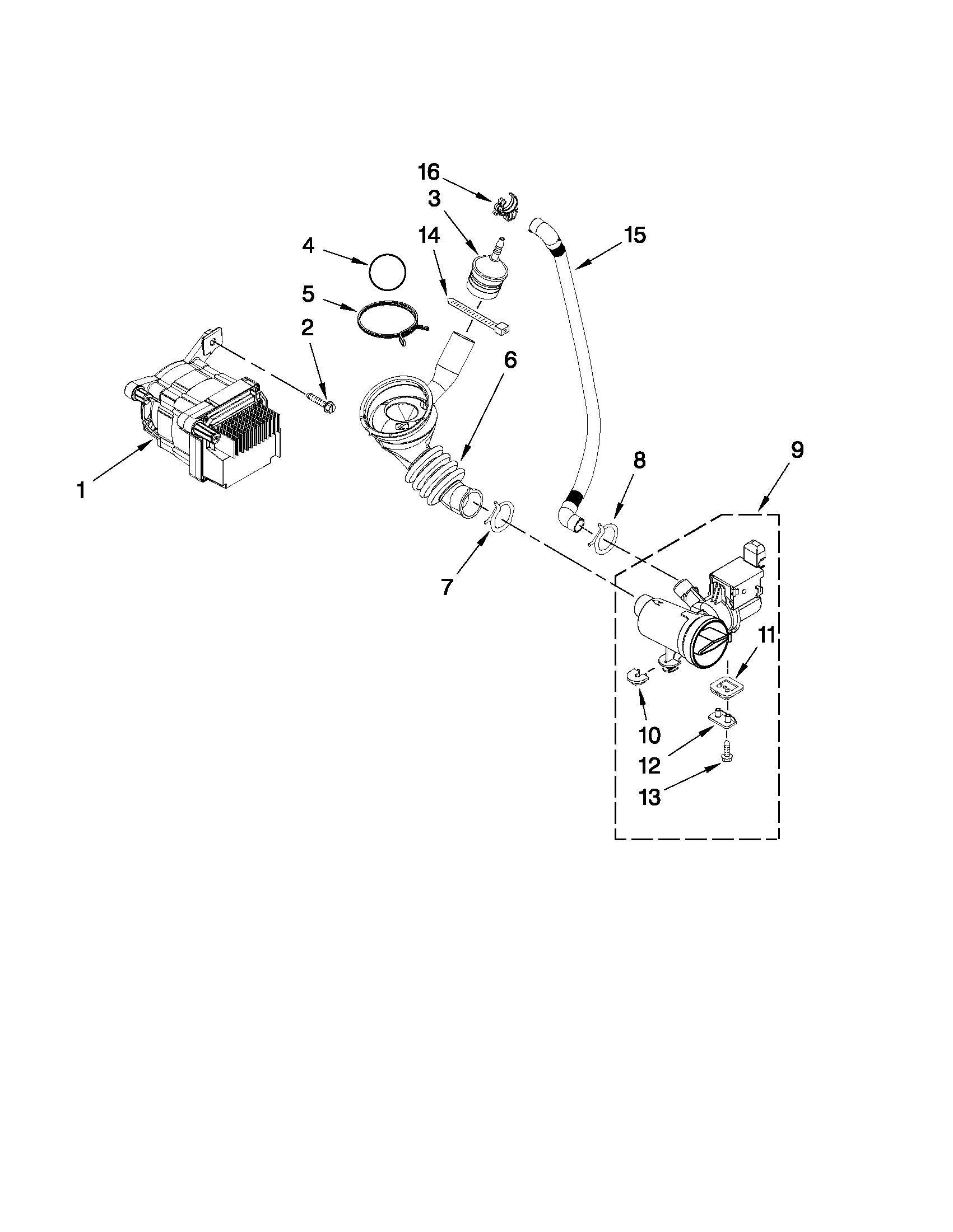

#7 RegUS_PatOff
  • 30,269 posts
Posted 23 January 2013 - 07:05 PM
... using a "inverter motor" like GE topload, the mcu is right on the motor and part of the motor.
Had to look twice the first time i saw one.
for reference:
Drive Motor
W10315848

#9 gregaguilar
gregaguilar
  • Chief Appliantologist
  • 11 posts
  • Flavorite Brew:bud lite
Posted 23 January 2013 - 10:58 PM
believe me this amana front load washer has the mcu attached to the motor and i am still having problems with it  i took a motor with the mcu attached to it and to no avail even though i knew the motor is good then i took volt from ccu to motor and was good but still same problem f6e2 code manana i will go g
et other ccu board and attach to unit if it do not work i dont know but i have ohmed every wire to this  unit but to no avail.  how much is there to this unit?
the inverter you are talking about seems to be the ge thiough the pic sure looks like this f/l  give me a call 325-651-5938 or 325-763-2560 san angelo tex I really need the help

#11 RegUS_PatOff
  • 30,269 posts
Posted 24 January 2013 - 02:04 AM
Whirlpool Washer WFW94 WFW95HEX Direct Drive
L-85 JOB AID W10372167
(I'm still looking for this service manual)
Tech Sheet - W10385295.pdf
#12 kdog
    RoughShod
  • 7,428 posts
  • Location: Canada
Posted 24 January 2013 - 02:16 AM
Definitely NOT the design I had pictured, haven't seen this yet either, by the diagram though if you have 120v into the motor/module ass'y and motor won't run - would seem to be defective motor/module ass'y.  Also has very strange looking W/L switch :
