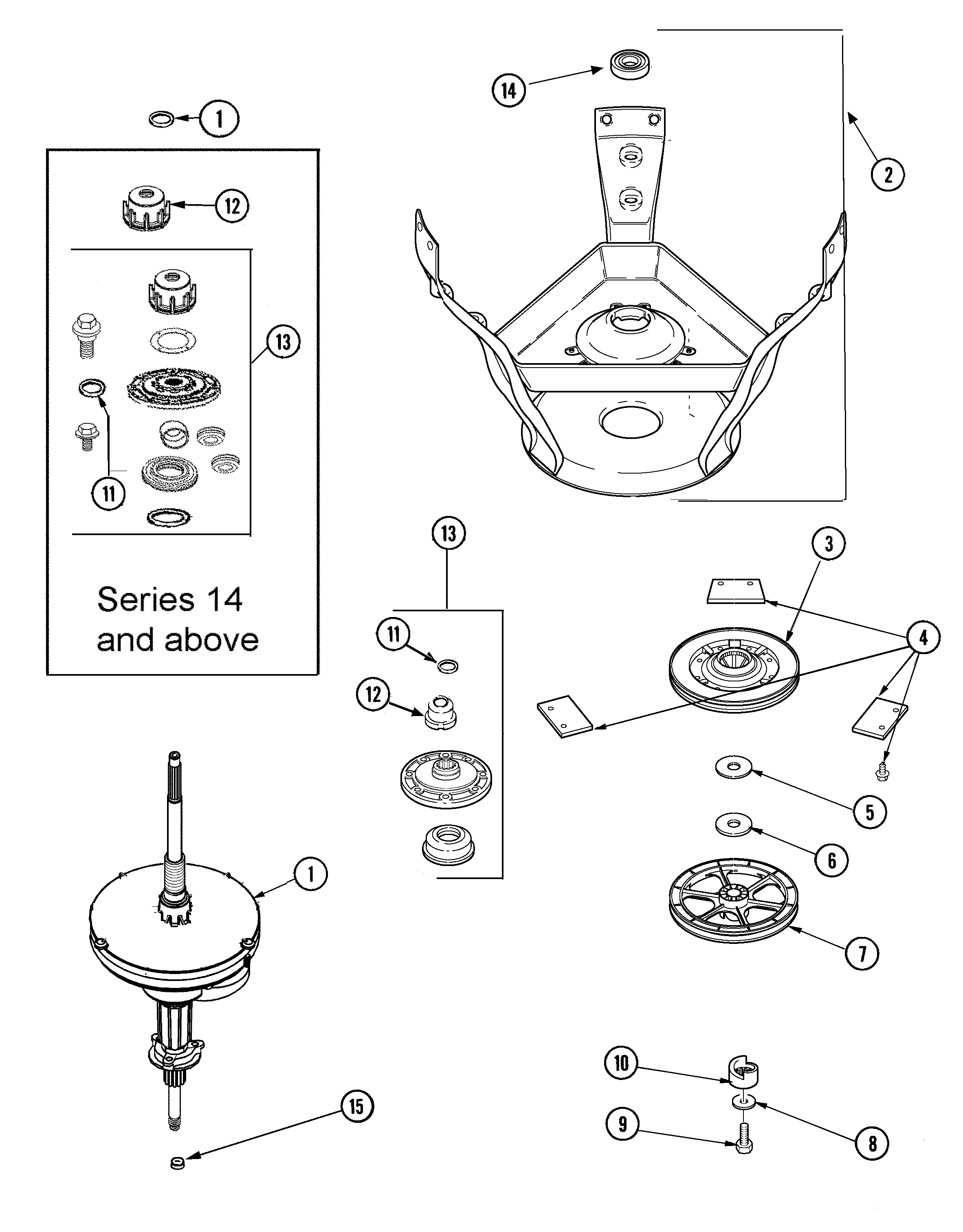

Ok I know I am gonna get thrown under the bus about this washer, but the person I am fixing it for insists on me fixing their washer....so please re-frame from rock throwing......
I have this type of seal head.....I am trying to track down tub seal kit for this washer. The problem was a loud roaring spin cycle...shot bearing from a leaking tub seal.
Now I have notice these washers come in two types of seal heads......one solid piece w/a triangle housing (what I have) for the bearing and the other is open style #11 on the B&W pic.....I need the seal for the triangle housing solid piece
Just need help in the right direction....thx!

OK I have the parts on hand that you posted....but looks like they will not fit my application. If I install the seal mentioned above then I will have 3 bearings installed....this does not seem right...
1 inside the tub, 1 on the seal head and another on the tranny...

If I cant find a seal then my last resort is cut the seal head over to the 1st lip to match the one in the diagram....if I do that then the bearing may not seat up w/the tranny......

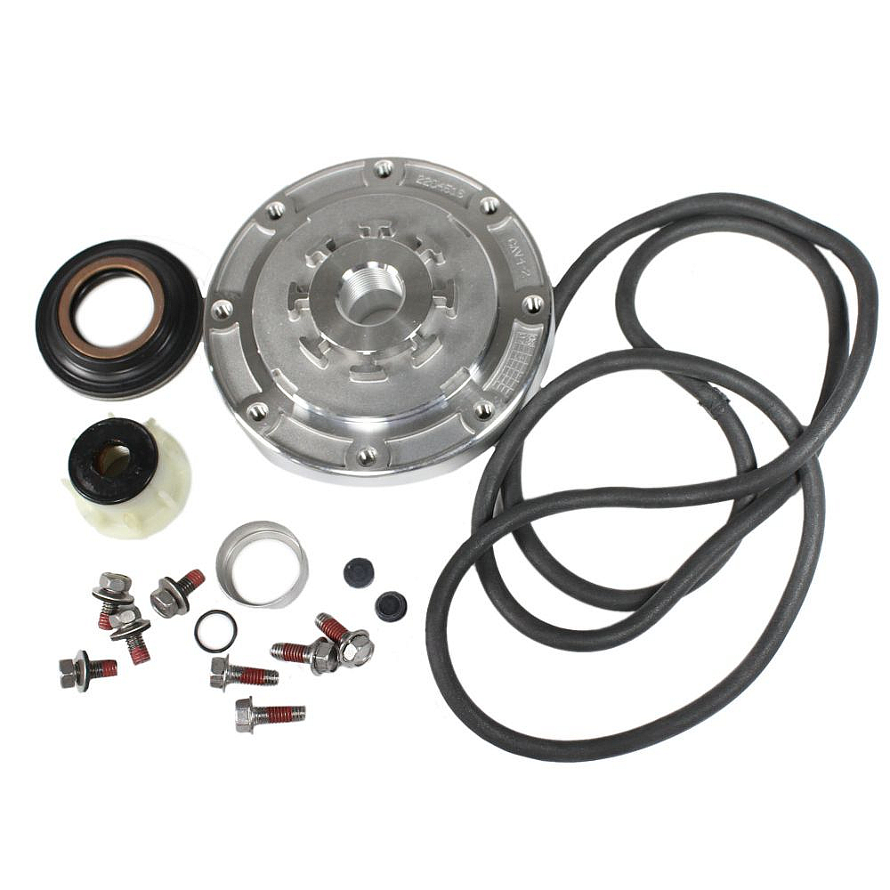

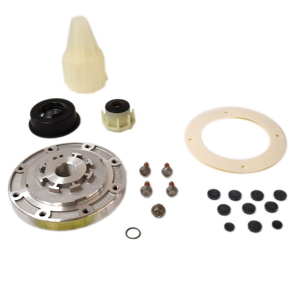

W10116790
PD_0026_464_W10116790?op_sharpen=1&qlt=1
W10116791
PD_0026_464_W10116791?op_sharpen=1&qlt=1
Edited by tpoindexter, 02 February 2013 - 01:02 AM.

There's 2 to choose from. I'm assuming that's why RegUS ask in post #2 "is this the one?"
And then, pasted the picture. You'll have to choose which you have.
W10116790
W10116791
Looks like what I need is the top pic....I already have the bottom kit and it will not work
Edited by rolandvz71, 02 February 2013 - 11:11 AM.
#9 RegUS_PatOff
  • 30,287 posts
Posted 02 February 2013 - 11:19 AM
There's 2 to choose from...
series (serial number) dependent

serial # 14126313GC
#11 RegUS_PatOff
  • 30,287 posts
Posted 02 February 2013 - 11:30 PM
serial # 14126313GC
that would seem to be series 14 and above ...

So process of elimination would be tub seal kit # W10116790
    Your Sometimes-Lucid Host
  • 24,356 posts
Posted 04 February 2013 - 08:46 AM
Tub seal and bearing kit ==> http://www.repaircli...0116790/1256957
Tub-Seal-and-Bearing-Kit-W10116790--0135
