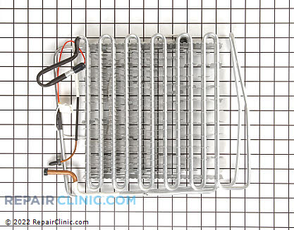

Thank you for helping me out here. When I go through the Q&A on Repair Clinic it shows me a defrost thermostat, DA47-10160H, but I don't see that part when I look at the unit.
I reviewed all the parts on Repair Clinic and what I found that does match is a defrost sensor, DA32-00006W, the thermal fuse which you showed me first and of course the evaporator with heater, DA96-00020Q.
The thought that the system has to be cut in to in order to replace the heater is not comforting. I called a couple of repair places this morning and it's going to be a week to 10 days before I can get someone out. I can't believe out of all the people I know in this world I don't know someone who does refrigerator repair.
But I do have a question. Is there absolutely no way to repair or replace the defrost heater without cutting in to the system. Perhaps retrofitting another heater or something? It really irks me that the heater is not separate.
Also, I purchased the unit in 2006 from Lowes. What are the odds of me getting this fixed under warranty? I'm thinking no... but was wondering if anyone had experience dealing with Samsung. Is it reasonable that this would fail after 6 years?

1) that's for the Freezer Evaporator
Is the Defrost Thermal Fuse OK ?
there is a way to replace the Defrost Heater (If it's bad)
(may be different part numbers for your model)
http://appliantology...odel-rs265labp/

Yes, the Defrost Thermal Fuse checked out okay.
I just had a conversation with Repair Clinic and the heater is definitely attached to the evaporator and they could not recommend a separate part for installation.
I guess with that, I'm stuck waiting for a technician.

... Would it be that I purchase the evaporator and take the heater off?
1) sorry, that was in a special service are forum...
2) yes
... found a way to replace the broken one...
... It's not fastened by screws...
... rivets which you'll have to grind the head off.
When you put it back together you could put more rivets in or sheet metal screws.
... pictures that show the separated defrost heater and evaporator...
... The old one was burned out at the joint.
Evaporator w/ Heater is not a bad price ...
ASC20051129001.pdf
Maytag or Samsung part
DA59-00234H
Refrigerator evaporator and heater assembly
This part has been permanently discontinued by the manufacturer (? ? ? )
and we don't know of any source for the part
pssst ... maybe here
OR here
http://www.repaircli...R=154&N=1076322
A few extra tips........
...bend the tabs a bit...
....grind the offending rivets off from both the old and new heaters...
..the wire will need to be rerouted, I just removed the pin from the connector,
did not want to cut and reconnect the wire..
I got more pics. if'n you gets stuck wacko.png .....keep us posted...
