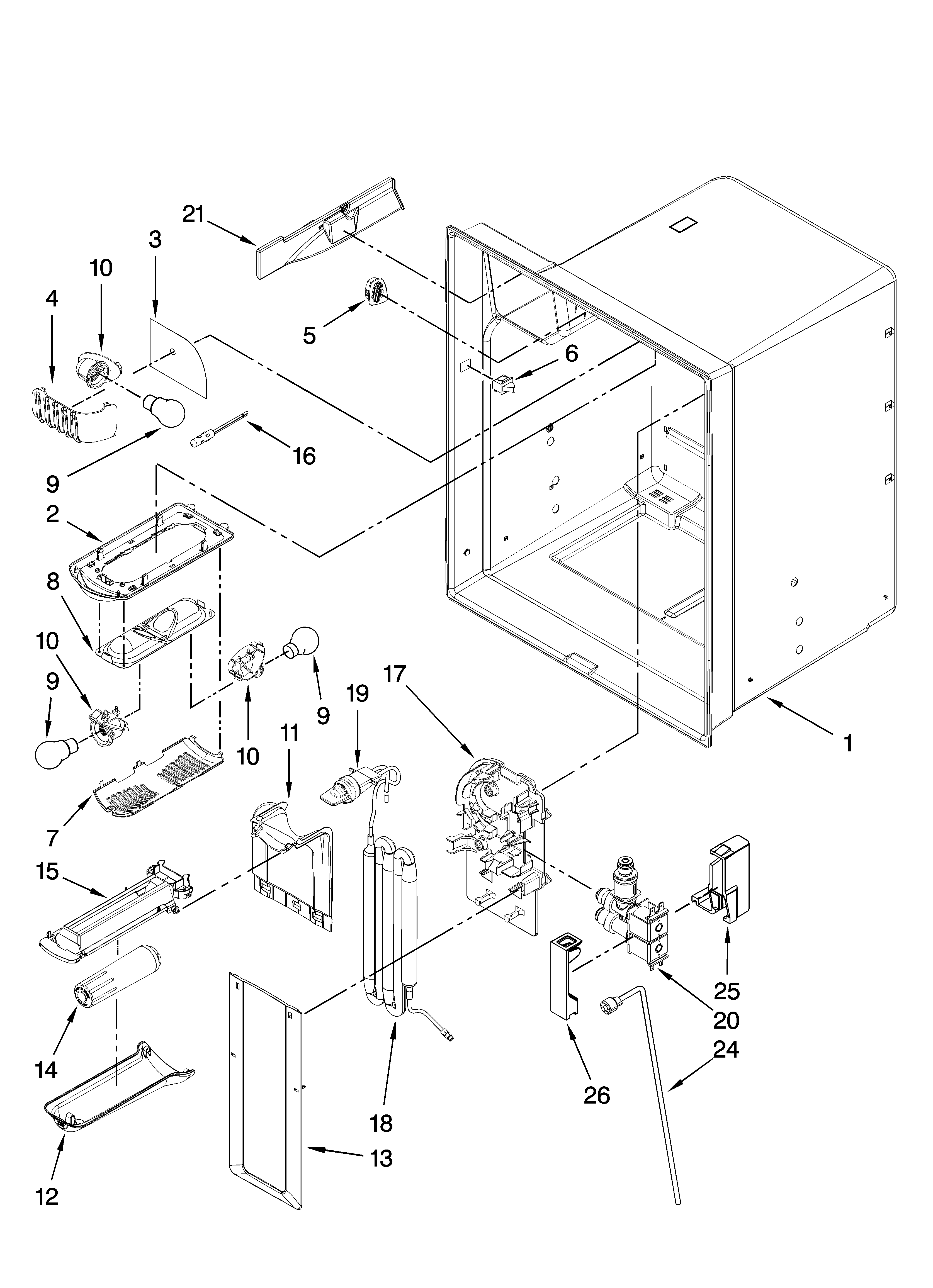

#2 Comstock_Services
Comstock_Services
  • 462 posts
Posted 06 February 2013 - 11:46 AM
#16 is the thermistor, you would need to remove the light components to gain access to it for testing. Looks like the one on the celing is where it will be. Also remove the front kick plate at the bottom, and look for the tech sheet, on the back of the kickplate grill or on the bottom right from the front, of the bottom of the cabinet. this will help with diagnosing the too cold, situation you are experiencing.W0808025-00002.png

#4 DurhamAppliance
    Sho' Nuff Chozin
  • 1,743 posts
Posted 06 February 2013 - 01:03 PM
In diagnostic mode, test both the freezer and fresh food thermistors. If they both pass, manually test them (computers lie all the time). Freezer thermistor is located on the evaporator cover panel   ..inside a small housing the clipped to the right side of the  panel.
