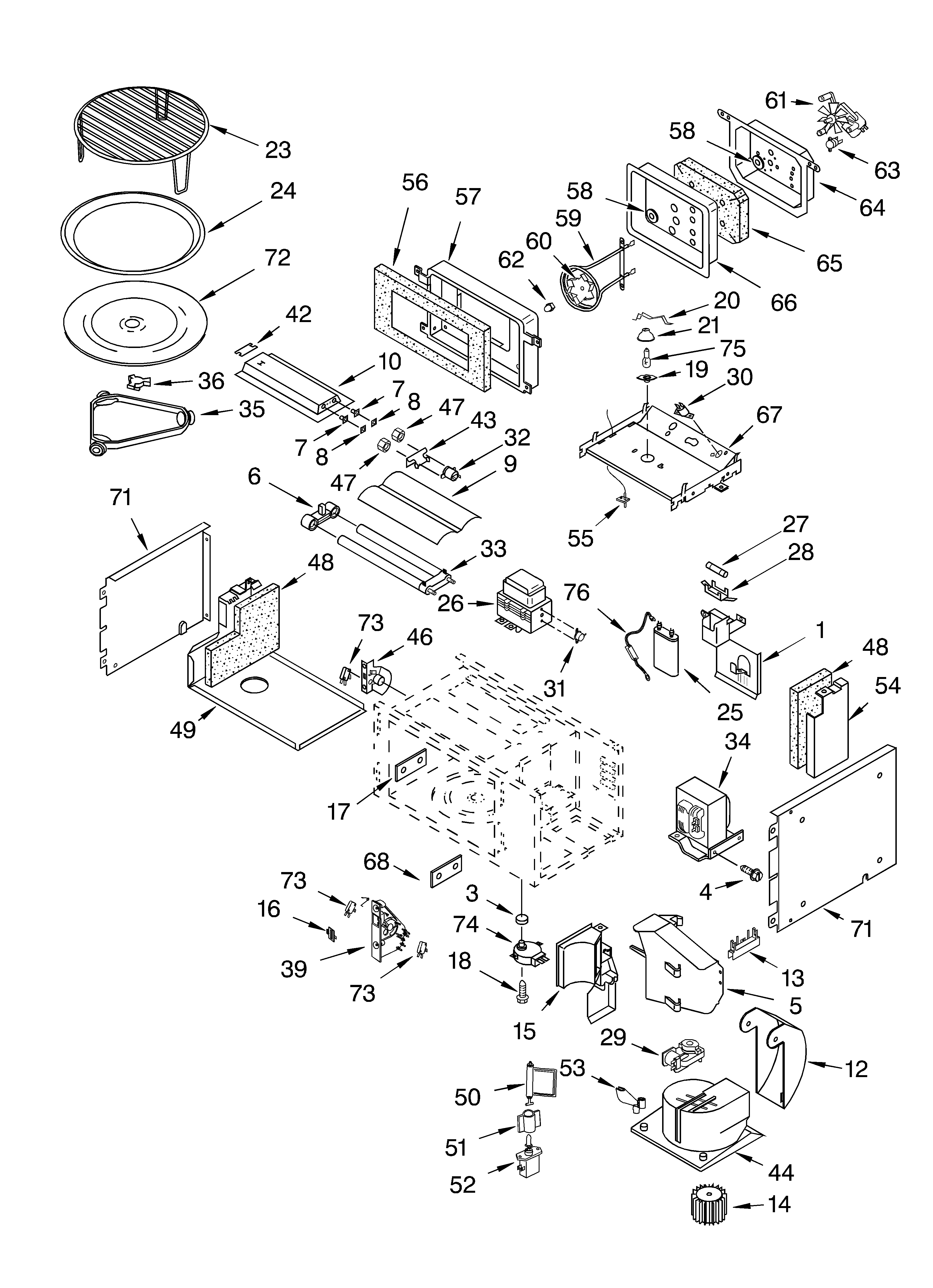

I bought this combo wall unit new back in 2002. The microwave portion stopped heating food and started emitting a bad smell like burning wiring or electronics. It also does not sound normal when you try to run it. There are no error codes and the bottom convection oven works fine. Any help would be appreciated.

Abnormal sound and bad schmeel-- I'd start troubleshooting right at the magnetron.  Use the Willie Method ™ to assess its health ==> http://appliantology...magnetron-tube/
Magnetron part link ==> http://www.repaircli...ber=KEHC379JBL4

The description in the link you provided exactly matches what I am hearing and smelling. Is it a difficult job to get to the magnetron? I guess I might as well replace the bulb and door springs while I have it apart.

I'd say it's somewhere between a rectal cramp and a root canal.  Here's the service manual ==> http://appliantology...en-combination/

My best advice for getting the microwave out is to remove the 2 side trim peices, then with the breaker off, remove the control pannel, and then remove the upper and lower black plastic vent pannels to gain access to the screws that secure the microwave, have someone help you pull it out from the cavity, there will be a long green wire, that attaches to the back of the microwave, dont cut it unscrew it from the back with your helper holding the microwave. If the door springs arent busted I'd leave well enough alone for now.W0110069-00006.png
