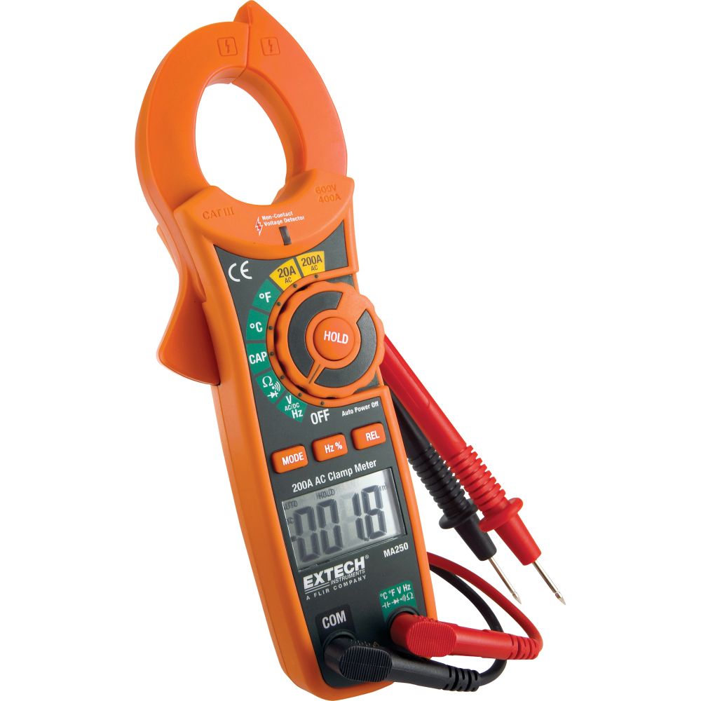

click on picture sale $ 35
(up to 100 uF)
03414179000?hei=185&wid=185&op_sharpen=1

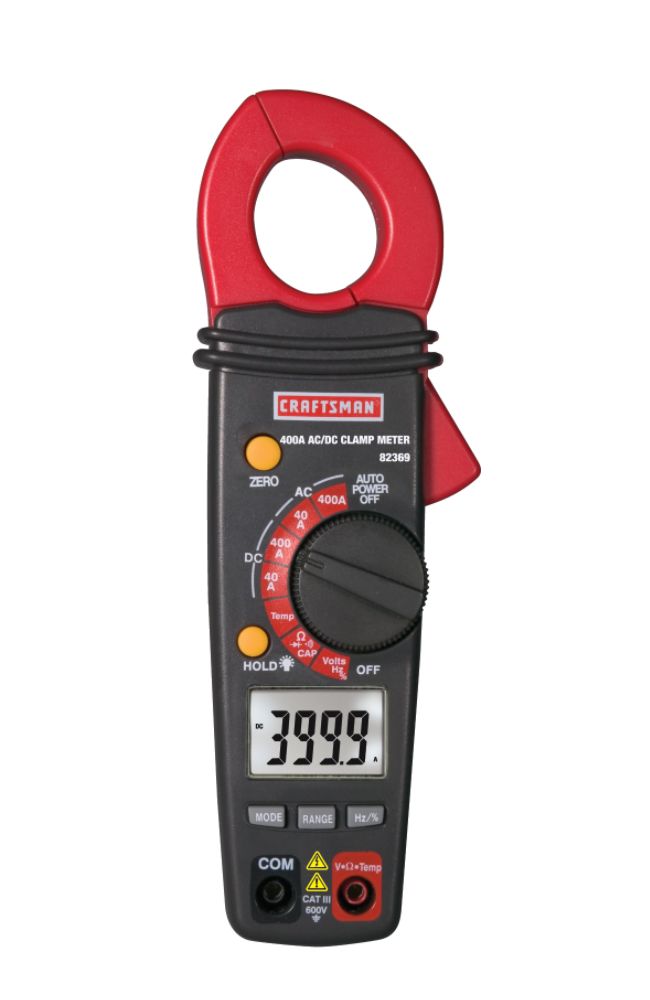

click on picture sale $ 54
(up to 100 uF)
03482369000?hei=185&wid=185&op_sharpen=1

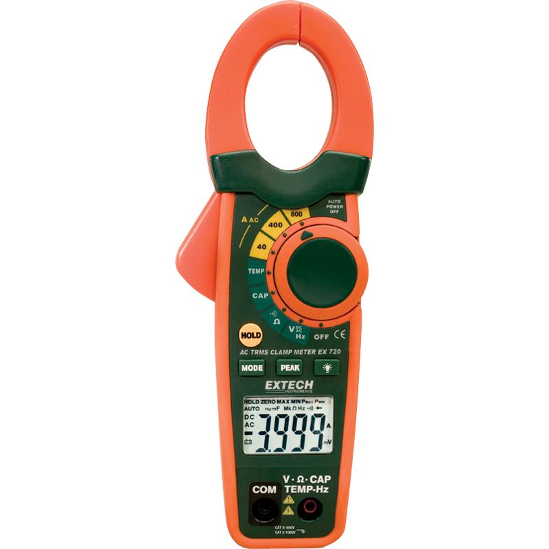

click on picture sale $ 99
(up to 40,000 uF)
03473756000-1?hei=185&wid=185&op_sharpen

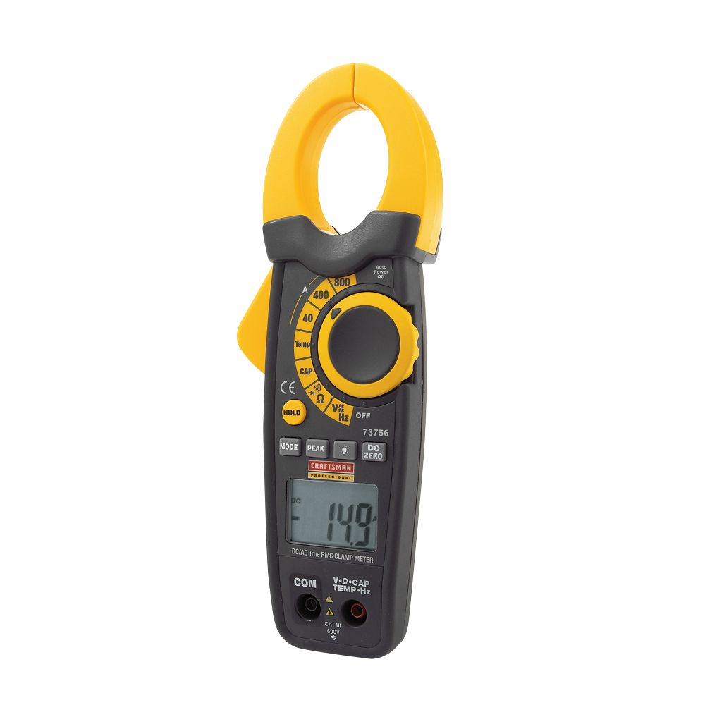

click on picture $ 110
(up to 40,000 uF)
03416253000?hei=185&wid=185&op_sharpen=1
