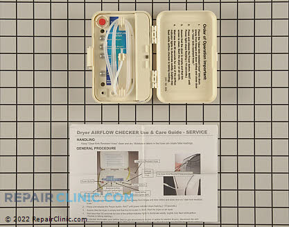

  The Samurai talked about this vent tester in a post I can't find. The instructions say that this tester is for Whirlpool made dryers only. Does anyone know if this is true or just a disclaimer.http://www.repaircli...0106710/1447456Tester-W10106710-01180018.jpg

I have that tester and it was designed to primarily work on the classic whirlpool dryers.  I can't remember exactly my thought pattern but when I first got it, I determined you can use it on other dryers by establishing a  reference point for that particular dryer and ignoring some of the built in warnings designed for the whirlpool dryers. Have not tried out this theory.

I've tried it on different brands of dryers and it works the same way.  It's just marketing hype by Whirlpool since it's their product offering.
All dryers work the same way:  heat the clothes to turn water trapped in the fabric into water vapor in the head space of the drum.  At 100% humidity, the air in the drum space is saturated and can't hold any more water vapor not matter how much heat is added.  That vapor has to be removed to keep the head space at a certain relative humidity to continue the water transfer process from clothes, to air, to vent.  The vent is key to removing the water vapor.  The instrument is really just a pitot tube that measures negative pressure.  The key variable in pitot tubes in fluid density (the air-water vapor mixture).  So this pitot-tube based instrument will work the same way in any dryer operating in an air-breathing home here on earth.  Now, if it were a dryer, Whirlpool or not, operating on the Moon or Mars, this instrument would not be properly calibrated for those fluid (atmospheric) densities.

A good appliance tech is like a good lawyer (but cheaper), we only ask questions we know the answer too. I love the tester, I can put my meter leads across the hi limit on a dryer and show a homeowner and builder that the vent is the issue all day long as voltage is present when the hi limit opens (120 G or 240 E) when the vent is connected and then show how it cycles on the regulating t-stat with the vent off, but they will not believe me or know what I'm talking about. I use the vent tester it has pretty flashing lights and comes up Poor with the vent on and good with it off, that's better then a note from their brother in law the plumber! We know before we test a unit for the most part. I've used it on all brands to prove a point (if it does not  prove the point I want I put it back in the bag!). It was designed for the Whirlpool top filter and filter in the door units, but it seems to work on almost all. The one it does not seem to be real accurate on is the Cabrio style dryer with the blower belt. I've tested short runs, 4 feet rigid with an elbow right out the wall to a working vent cap and had the meter show poor vent.
