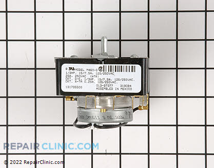

Replaced timer but still not advancing. Can the control thermastate stop it from advanceing.Any other options That might cause it. HERB

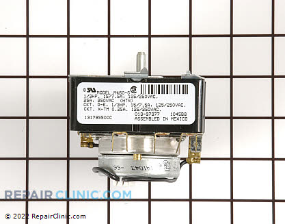

aahhh .. GE Roper Hotpoint NVL33EB6WW built by Frigidaire
Timer should run OK in Air-Fluff cycle
In Auto Dry cycle, Timer only runs when either Thermostat "opens"
(Heater must be working OK)
Parts manual & wiring diagram
95353728.pdf
for reference:
GE Timer WE04X10042 $ 124
(has Frigidaire's part number on it 131795500 )
http://www.repaircli...?R=154&N=877365
Frigidaire Timer 131795500 $ 77
http://www.repaircli...?R=154&N=936406

Thanks guys replaced timer and control thermstat. unit working fine.
