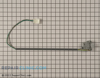

I think bigbuck has it right, sounds like a bad lid switch

  If it never drains or spins, it's likely the lid switch. Here's a video on how to jump it out. Yours is the second type switch in the video.
http://www.youtube.com/watch?v=XAnQ6Ovvnuc
  Those switches have a tendency to come apart and can be glued back together or cinched with a small tie-wrap rather than replacing it.

You guys are geniuses!! It is the lid switch.  Now...how hard is it to replace?

Well it is all back together and it works PERFECT!!!  The help you gave me was amazing.  The switch cost $38 and I probably saved $200.  But I got so much satisfaction out of doing this myself.  I'm giddy over this!!!
