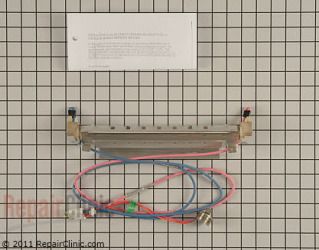

there looks like a vent about half way up  just inside of the door jam.  Would that be the return air port?  i will have to look tonight when i get home for the Defrost Thermostat?  I am looking at the picture I took yesterday.  It looks like the replacement Defrost Thermostat does not have wire clips on it.  Should i cut off the old clips and solder or is there a better solution to connect?

If you are going to replace heater and limit then I recommend you get part no. WR51X10029. The limit comes as part of this assembly. The separate parts will work just as well but you don't have to do any splicing with the assembly and you get a new harness.
Defrost-Heater-Assembly-WR51X10029-01219
http://www.repaircli...51X10029/880031
Regardless, the limit on the assembly as well as the stand alone limit has a built in clip

Thank you sir!  Unfortunately i already ordered the separate parts and looks like rather than wait for the new one I will go ahead and splice.  I did find the Defrost thermostat so I am going to splice it before the connection clip.  What is the your recommended  method to splice the two wires?.

Posted 04 September 2013 - 07:16 AM
heater
limit
www.DurhamApplianceThrift.com

That is an easy splice.  i thought i read somewhere to solder and then use the heat shrink connectors.  This is much easier.  Thanks.
