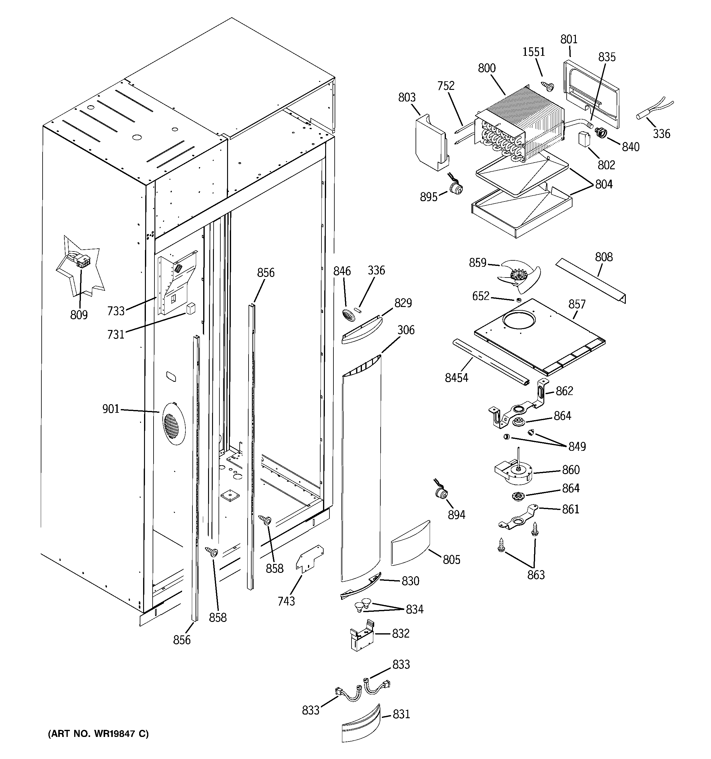

My GE Monogram (serial# ZISS420NRESS) won't go below 50. The freezer is at 1 degree. Any idea what could be causing this?

Is the Evaporator (Freezer) Fan running ?
Is the Damper open ?
May need to see the frost pattern of the Freezer Evaporator Coils

Damper is operating correctly -- I've actually troubleshot a freezing in the fridge compartment issue there... so I took out the stryofoam box and saw the damper opening and closing as it should.
I don't know how (or where to look at the freezer evaporation coils. Can you tell me how to access them, and what to do once I find them? Thank you. I have the freezer food out & ready to work.

#7 RegUS_PatOff
  • Academy Instructor
  • 33,588 posts
Posted 07 September 2012 - 07:44 PM
It may now be in a Defrost Cycle ..
If normally the Damper is opening, and the Fan is working,
then there should be cold air entering the Fridge ...
Unless the Fridge Light Bulb is staying ON.
Or the Fridge Thermistor is bad.
Or the Evaporator is air-clogged, or not freezing well.
http://fixitnow.com/...ed-thermistors/
For access to the Evaporator:
1. Remove the ice bucket.
2. Disconnect the icemaker connector.
Loosen 2 screws and remove icemaker.
3. Remove 4 screws and slide the icemaker drive motor assembly forward.
Disconnect the wiring connector and remove the assembly.
5. Remove 2 screws and wiring cover.
6. Remove 6 screws and evaporator fan cover.
then:
1. Remove the evaporator fan
(see Evaporator Fan procedure in the Airflow chapter).
2. Remove 8 screws and freezer ceiling panel.
3. Remove Styrofoam insulation from the bottom of the evaporator drain pan.
4. Loosen evaporator drain hose clamp.
5. Lower left side of evaporator drain pan and slide right side out of drain hose and remove.

Sounds like a mainboard/thermistor problem. I would change all thermistors then replace the board.

Also make sure your return duct is open. The way I check is to open the ff door and pin the fan switch closed. Put your hand in the airstream coming through the open damper and crack the Frz door open. If you feel a big increase in airflow the duct is clogged. The only solution I have found that positively solves frosted duct is unplugging box,opening both doors and giving it 24 hrs to deice.
