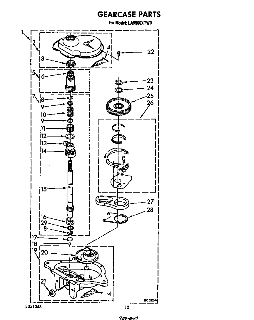

Washer does everything (fill, agitate, drain) except spin. Since it agitates the problem can't be the connector or clutch, but I checked them anyway and they are good. The transmission tests bad. When I turn the connector shaft counter clockwise the agitator shaft turns back and forth, but when I turn it clockwise the spin shaft does not turn. I see I can buy a 389244 transmission for about one to two hundred dollars, but I notice the tub basket is extremely stiff when I manually rotate it. Is this normal, or do I have another problem, perhaps bad bearings. Is it possible that the stiff-turning basket caused the transmission to fail? After twenty-one years of service maybe it's time for a new washer, but I'm amazed by the large number of negative reviews of the current Kenmore and Whirlpool top loading washers.

  So, when rotating input shaft CW, the clutch hub does not rotate? If that is the case, you may have a broken/mashed spin pawl, sheared spin pawl stud or a stripped spin gear. Gearcase is relatively easy to service and most parts are readily available.

I'm not sure that I can easily service the transmission. I don't have a proper work area, vise/stand, or retaining clip tool. And my wife is already loosing patience with me. I looked at the parts list and can identify the Spin Gear (62570), Spin Pinion (63320), and Spin Pinion Seal (356427), but don't see a spin pawl or spin pawl stud.

#9 RegUS_PatOff
  • Academy Instructor
  • 33,588 posts
Posted 28 October 2013 - 05:26 PM
http://www.repaircli...sp?R=154&N=2911
includes
# 26
Edited by RegUS_PatOff, 28 October 2013 - 07:55 PM.
