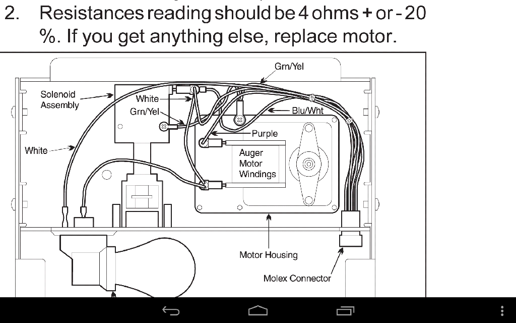

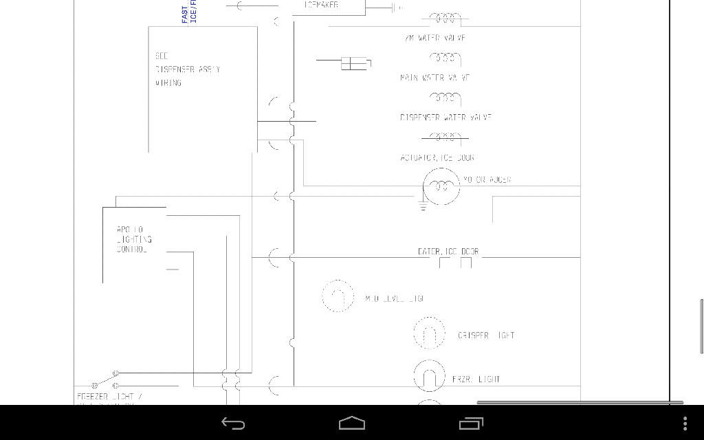

this is a tough one. Your freezer light does connect to your auger circuit.
Screenshot_2014-01-19-22-33-52_zpsvkwx9m
Try cleaning /reseating molex connectors and check for any wire shorting or damaged freezer light.
test your auger for proper resistance, the value is found in the above diagram.
Your light and auger both connect to The dispenser control..
Screenshot_2014-01-19-23-14-33_zpscs7wjm
*note the switch is on the hot line in the above diagram also the left line feeding the auger is hot and the right line is neutral
sorry about the resolution... Freezer light switch on the bottom left and the auger motor is represented by the resistor with the circle around it and a ground wire attached (it's about midway on the right side of the diagram)

The problem may well be with the dispenser board... there are two boards listed...
http://www.repaircli...ard-Timer-Parts
I have to do more research to determine which one could cause your problem if everything else checks out.
