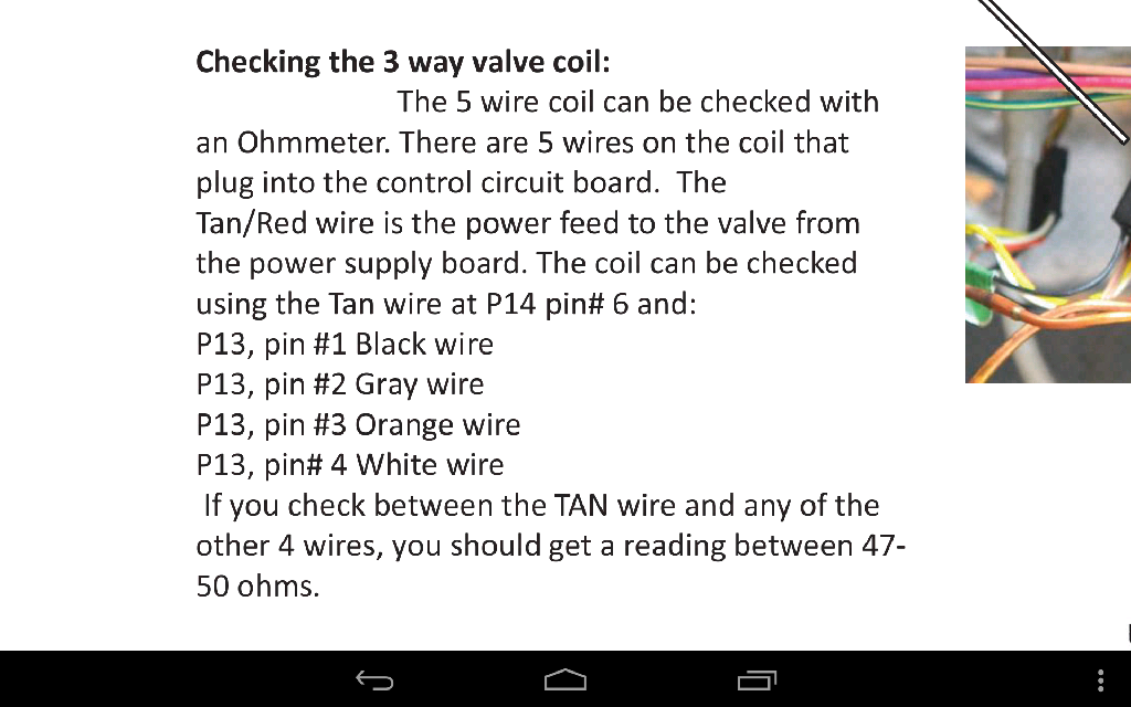

Cooling in fridge, but not in freezer. All service tests completed, but still no cooling in freezer after service test 4 (which should advance the 3 way valve) AND replacement of valve solenoid. The test functions are completely useless in verification of solenoid/valve operation... Wiring diagram claims voltage can not be read for solenoid.... Any ideas out there?

Model WRF989sdam00, solenoid part#w10364560

When you intiate the test, you are suppose to touch the 3-way to feel it change position. This is the standard 3way test for most models. You can, however, check the coil at the board for proper resistance:

In my last two experiences with this model, things went much the same as described above. The problem ended up being a sealed system issue requiring a new evaporator installation... I know this because the customers were still under warranty, but wanted a trusted opinion before proceeding with the warranty repair and let me see the job ticket. One of them mentioned a blockage disallowing refrigerant flow to the freezer at sufficient volume: Both machines had normal FF temps, but low 50's in the FZ. So, unless you relish delicate sealed system work, you may want to identify a decent Whirlpool factory outfit in your locality to dish these on when you diagnose this! In Chicagoland, Diamond Factory Service handled it without shame...
