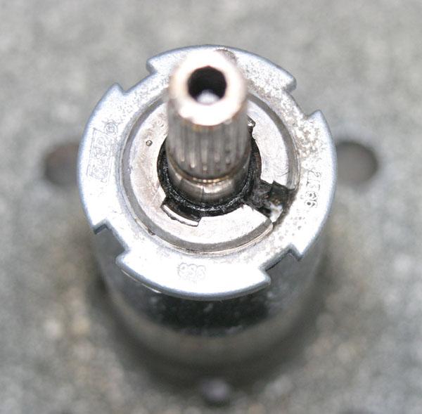

Started making banging/thumping noises during the rinse or spin cycles. Empty no less. :(
The coupler was intact but pretty much worn out. Replaced it and now the noise is even louder then before.
Doesn't happen during agitation and agitator works but as soon as the drum starts to spin up the pounding starts. The drum does spin up and the brake works when you release the cover switch.
Any suggestions?

Check the drive block. If the notches are worn smooth, that's your problem.

I guess I'm not sure what worn smooth means here. If you mean the notches are rounded out then that doesn't seem to the the problem. Or am I missing something.
Steve

NO, your not missing anything, the drive block is OK......
Can you locate the source area of where the noise is coming from?
From your picture it looks like spin basket is ok, maybe the plastic filter thingy on the bottom of the spin basket as came loose. Is the balance ring at the top of the spin basket attached good and tight?
Here's a link to a picture of the spin basket and outer tub, ref#12 is the lint filter.
CLICK HERE
Leave the agitator off and put machine into a spin cycle and see if noise is still there. This will eliminate the possiblity of the agitator top section being loose and banging.

Posted 06 April 2005 - 06:35 AM
Both the balance ring and lint filter are on solid.
The banging comes from below the spin basket in the center.
It still does it with the agitator off as soon as I activate the timer in rinse or spin.
The banging is quite loud. Is it common for something in the trans to let go and flop around but still agitate and spin.
It's almost like the wig wam is bashing around while the basket is being spun up
I'll try changing setting for agitation and see if the duration between thumps changes.

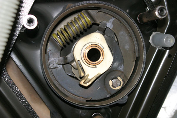

Check the plastic cam on the basket drive:
If it's broken, it'll cause the no-spin. no-agitate problem, too.  Can be very noisy.

Posted 06 April 2005 - 01:58 PM
Mine looks a little different but I don't see anything obviously broken. The cam moves about 10-15 degrees and does make noise at the limits that might be the banging it you put some power behind it. It has some slop around the center. I assume this cam couples to the clutch below and spins the tub. What does it engage with?

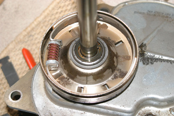

Just in case, here's the top of the transmission and clutch.

Whoa!  Great pics!  Everything looks normal there.  We've eliminated everything else, that pretty much leaves the transmission, compadre.  :(
Moment of truth time:  repair or replace?  Call the ball.

Your upper photo shows the square finger tip of the plastic cam is worn out.
During the spin cycle, the finger should engage securely to the square (should be rectangular) holes on the clutch side.
Due to the wear of the tip, the finger fails to engage securely and bangs onto the end part of the spring on the clutch side.
You need a new cam!

Are those the slots in the base of the clutch plate?
Replacing the cam looks like I just have to remove the retaining c-clip and pull it out. I hope that's all that's wrong.

Yes, you get it at last (hopefully).

I been trying to figure out how the clutch would work if the cam engaged with the slots. That would eliminate the clutch shoe from the process.
After I took the cam off the brake, it seems to me that the cam engages the longer of the two arms on the clutch shoe where the spring is, latching onto it and coupling the basket drive to the clutch case.
I inspected the cam and I can still see the mold and flashing marks in the surface as well as contact grease transfer in the face that engages the clutch shoe. There is minor wear in the face of the thin finger that would contace the cap on the clutch shoe spring. Less than a 1/64" deep and about a 1/4" long. I really don't think the cam is worn out.
I hooked up the motor to the trans, it doesn't bang but it does run rough, almost like some teeth are chewed up in a gear. Not having three hands at the time, I couldn't put any load on the clutch disk to make sure.
Do you have a better diagram of the internals of the trans than the small gif on msn that you could share? Perhaps, I misunderstood the repair or replace question. I assumed you were asking about the transmission not the washer.

Looking at your pictures, I would say the brake cam looks fine to me, I don't know what "The Seven" is seeing that I'm not.
Question for Samurai:
You said "If it's broken, it'll cause the no-spin. no-agitate problem, too. Can be very noisy."
You were speaking of the brake cam. Can you tell me how a broken brake cam will cause a "no-agitate problem too"? I believer your mistaken, the brake cam has nothing to do with agitate.
Another thing that could be the problem, The brake drum could have came loose, turn the brake cam to release the brakes and try to move the outer brake drum, it should be solid no movement.
From everything you have told us, I'm really leaning towards a transmission problem and most likely a problem so severe that it's not worth trying to repair the transmission. (reason being if it's the input shaft/worm gear and pinion gear, you have to purchase the lower tranmission case with the two gears, the worm gear/input shaft is pressed in. This one part of the transmission cost almost as much as a new transmission)
I think what you will find if you open the transmission is that the main pinion gear that the input shaft/worm gear engages has broken some teeth off. I have seen one do this before. It agitates ok with just a little noise because turning in the agitate direction doesn't produce the load that spin does. In the spin cycle the load on the transmission is much heavier and you get the loud banging everytime the broken tooth area comes around.
I bet the banging is at constant intervals, right?
