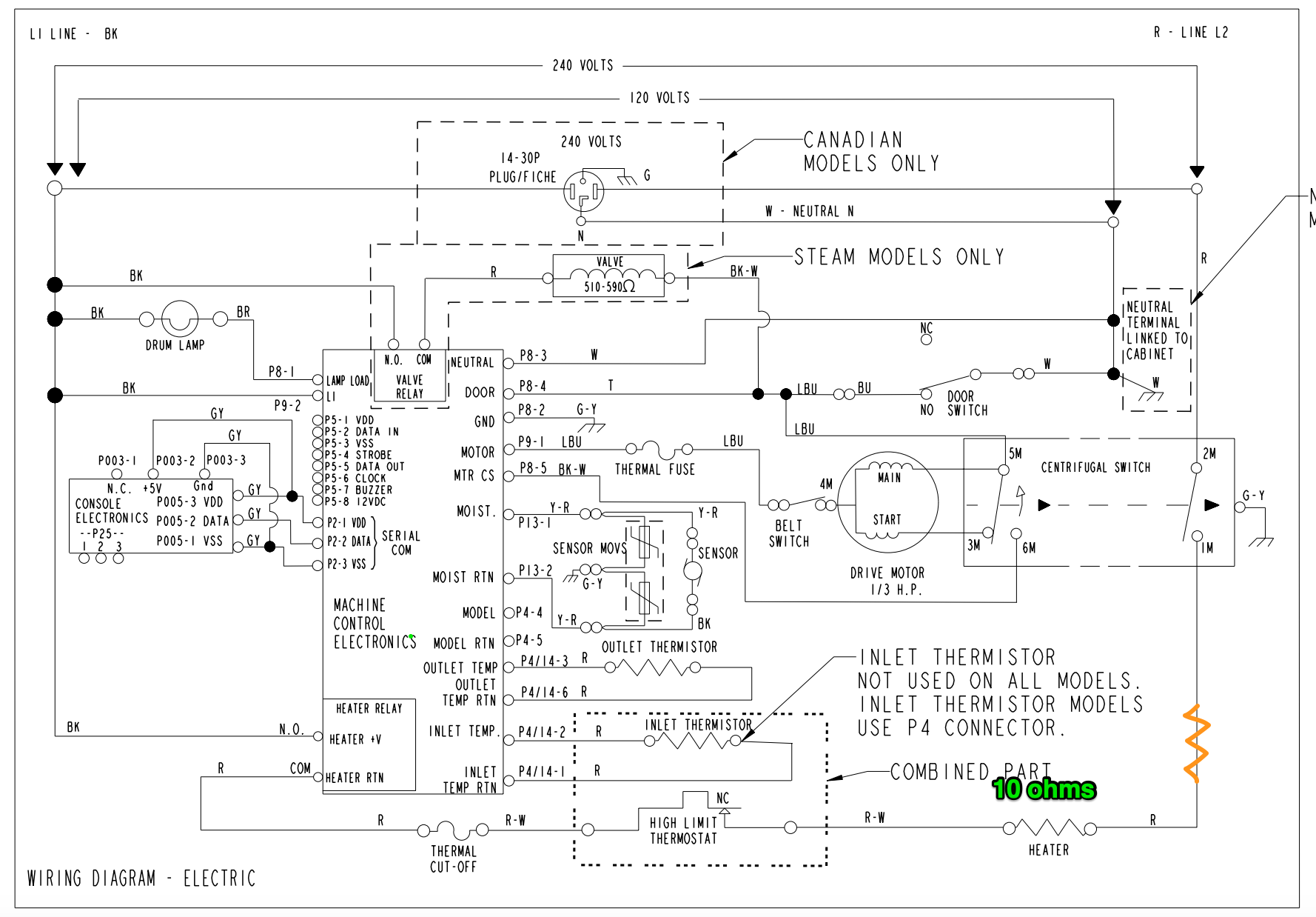

    [Yes, I did reset the breaker and checked the voltages. Here's the wiring diagram:
    Source: Amana NED7200TW Dryer no heat, problem with cycling thermostat?
