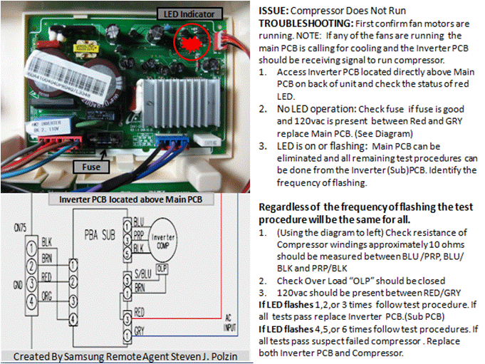

Models:
RF265ADBP/XAA / RF265ADPN/XAA / RF265ADWP/XAA / RF266ADBP/XAA / RF266ADPN/XAA / RF266ADRS/XAA / RF266ADWP/XAA / RF267ADBP/XAA / RF267ADPN/XAA / RF267ADRS/XAA / RF267ADWP/XAA / RF26VADBP/XAA / RF26VADPN/XAA / RF26VADWP/XAA / RFG237AABP/XAA / RFG237AAPN/XAA / RFG237AARS/XAA / RFG237AAWP/XAA / RFG238AARS/XAA / RFG295AABP/XAA / RFG295AAPN/XAA / RFG295AARS/XAA / RFG295AAWP/XAA / RFG295ABBP/XAA / RFG295ABPN/XAA / RFG295ABRS/XAA / RFG295ABWP/XAA / RFG297AABP/XAA / RFG297AAPN/XAA / RFG297AARS/XAA / RFG297AAWP/XAA / RFG297ABBP/XAA / RFG297ABPN/XAA / RFG297ABRS/XAA / RFG297ABWP/XAA / RFG298AABP/XAA / RFG298AAPN/XAA / RFG298AARS/XAA / RFG298AAWP/XAA / RFG299AARS/XAA / RFG299ABRS/XAA
