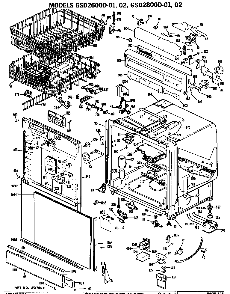

I've never ran across one of these so I'm just going by what I see in the parts diagram.
This is an electronically controlled dishwasher. There is a sensor on the side of the tub ref#914 in the diagrams which is not listed in any of the part break downs so maybe no longer available part. I believe this sensor somehow gives feedback to the electronic control module to let it know the spray arm is turning.
I don't know if the spray arm has a magnet or a piece of metal in one end, (I don't see anything that looks like it could be a magnet in the pictures of the spray arm), to activate that sensor or maybe the sensor feels the vibration of the water hitting the side of the tub, but I suspect the C5 error maybe because it thinks the spray arm isn't turning, (if you didn't have a enough water in the dishwasher it wouldn't create enough water pressure to turn the spray arm thus spray arm not turning machine thinks not enough water so gives the C5 error but it may really be a sensor or controller causing the problem).
Also, doesn't appear the special check valve with the long stem is available anymore either, shows as part ref#557 in the diagrams but not listed in the part break downs.

That's the picture.
Samurai, from reading the tech sheet you supplied it doesn't sound like my conjecture was correct at all, maybe good reasoning considering never seen or worked on one of these but wrong non the less.
I would say the problem is the water draining out while it's washing, that shouldn't happen and that is why the drain is shorter then 10 seconds and is giving the C5 error.
You may think the drain is longer then 10 seconds because the motor will be running each drain cycle for the full 1 to 2 minutes the drain cycle requires but there is a micro-switch on the drain flap solenoid which lets the controller know how long the drain flap was open, so actually pushing water out not just running empty of water, (Now I know what that micro-switch is for also if I should ever run into one of these. I had no idea what it was for when I was looking at the parts break down and was actually wondering what it's purpose was.).
Does your dishwasher drain down thru the floor or does it go up to an air-gap on the back of the sink or at least have a high drain loop in the drain line before it drains into the garbage disposal or sink tail pipe?
Make sure the spring is in place and not stretched out so the drain flapper is held in the solid closed position when in wash. If the flapper seal has been somehow damaged inside the pump body your would have to replace the complete pump/motor assembly and it might be a good idea to go shopping for a new one. Lots of specialized parts for your particular model are no longer available.
