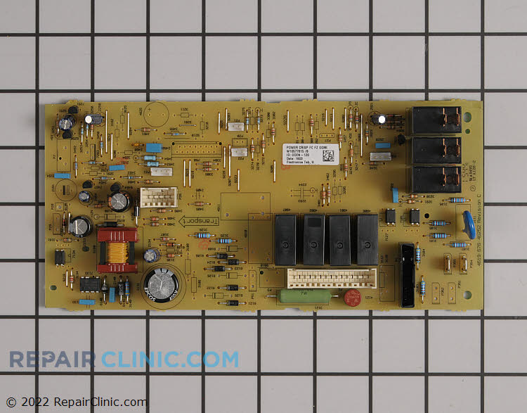

KitchenAid Microwave F1E5 MW Inverter error
flymike
I have a KitchenAid KEMS379B builtin microwave/oven combo. It will run for a little bit, then stop and show ERR F1E5 MW INVERTER message. If I keep clearing the message and restarting it, the food will eventually reheat/cook but it takes significantly longer. What needs to be done to fix this? Also does the whole unit need to come out (sadly I think it does) or am I able to fix it while it stays mounted in the cabinet?
Thanks for your help,
Mike

You will have to pull it out to expose the parts... microwaves are not the easiest to work on-
F1 Internal E5 Microwave Oven Inverter Error
SUGGESTED CORRECTIVE ACTION PROCEDURE NOTE: Before starting any test, cycle power to the oven (power Off, wait 10 seconds, and power On). After powering on, start a microwave cooking function and wait 1 minute, then verify that the failure appears again.
1. Unplug oven or disconnect power.
2. Check that the P21 and P22 connections of the Microwave Appliance Manager are firmly connected. If they are, go to Step 3. If they are not, reconnect and go to Step 6.
3. Disconnect connector P21 from the Microwave Appliance Manager, and measure the resistance of the thermistor. It should be (approximately) 10kΩ at 77°F ± 10°F (25°C ± 10°C).
4. Disconnect connector P22 from the Microwave Appliance Manager, and measure the resistance of the thermistor. It should be (approximately) 230kΩ at 77°F ± 10°F (25°C ± 10°C).
5. Check thermistor for short to ground. If check on thermistor is not correct, replace the thermistor. If thermistor check is correct, replace the Microwave Appliance Manager
6. Replace all parts and panels before operating.
7. Plug in oven or reconnect power.
8. Verify operation is normal. Re-enter the Diagnostics Mode and erase error code(s).
Control Board W10811595       Alternate Product View
W10811595  this the Microwave appliance manager...
