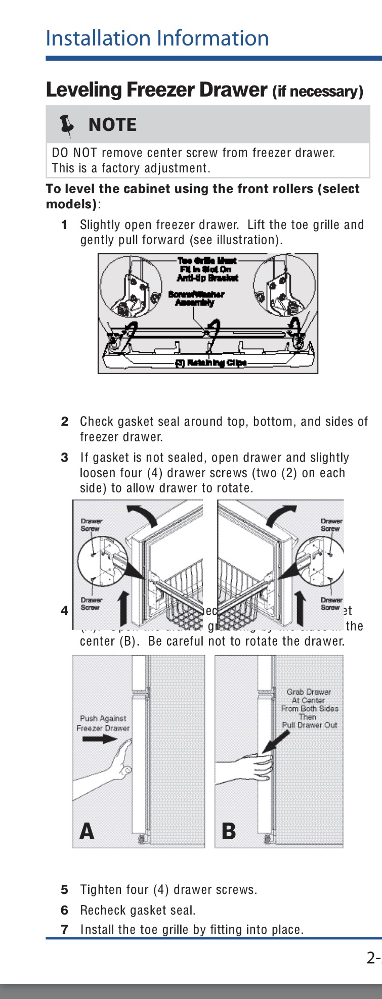

Manual needed.  Seems as freezer door is self adjusting.  Spent an hour de-iceing due to left a while and slight gap in top right corner, but could not find adjustments.  Tried "bending" to compensate, seemed like was made to adjust slightly but not sure.

Just found this applicable for the 2013 one i requested.  This was how to adjust the door!
