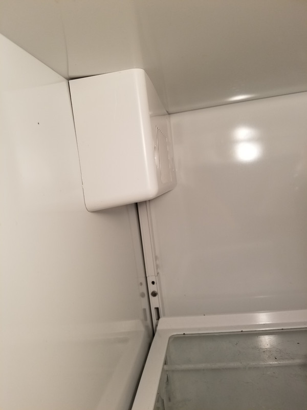

If your ice cream compartment is cold and your beer compartment is warm, your condenser and all the cooling stuff are most likely working fine.  If the fan inside the freezer is working fine then the most likely causes are the port(s) between the two compartments are clogged with ice.  Thaw them out with a steamer or hair dryer.  You can use a heat gun if you are really careful.  Could be the little damper (door) that opens in the refrigerator to let the air through is not opening.  Check that.  If there is not cold air blowing in the top left of your fridge, something is blocking it or the return port at the bottom.
So first question is: Do you feel cold air blowing through the damper?
No, there's no cold air blowing on the fridge side, but because of fan I can feel cold air blowing throughout the freezer side.
Can you please point me about the location of ports? I can definitely check and validate them to ensure it isn't clogged/blocked.
Your parts diagram
www.appliancepartspros.com/fresh-food-section-parts-for-ge-gss25wgpdbb.html
doesn't show it well.  Part 426 in that.
More info here.
fixitnow.com/?s=damper
Remove the panel with the light in freezer.  Look in top right corner.  Port is on the wall between the freezer and fridge.  Top of that middle wall at the back.

Thanks to both of you. I have installed the evaporator coils cover and just turned the fridge on, both fans are running but I still don't feel any air coming out of the right side(fridge side). Maybe will let it run overnight to see if I can see a temperature difference by tomorrow morning?
Yes, I have removed the ice maker already and can see a port at the top right - almost in the middle on freezer side. I touched it with my hands and don't feel any ice or cold temperature there?

Should I open 429 on the fridge side, to see 426 and see if it's having issues?
Thank you for the youtube link, totally understand which one you are talking about.
Link to comment
Share on other sites
That port is not in the middle of anything.
From the video:
www.youtube.com/watch?v=W8C0520E80I
At 0:11 here is the port from the fridge side:
