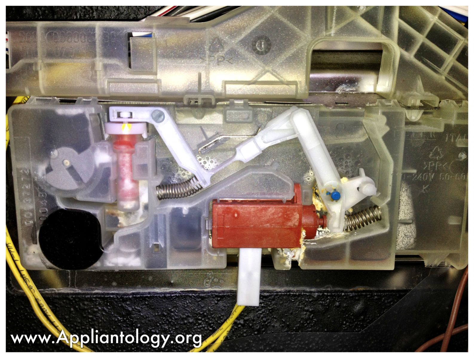

Bosch Dishwasher Dispenser Leak
Outer door panel removed. Look closely at the linkage on the wax motor and you'll see residue. If you see this, you need to replace the dispenser before the rinse aid vapors take out the circuit board. Buy the new dispenser here: http://www.repairclinic.com/Bosch-Dishwasher-Dispenser-Parts?RCAID=24038
