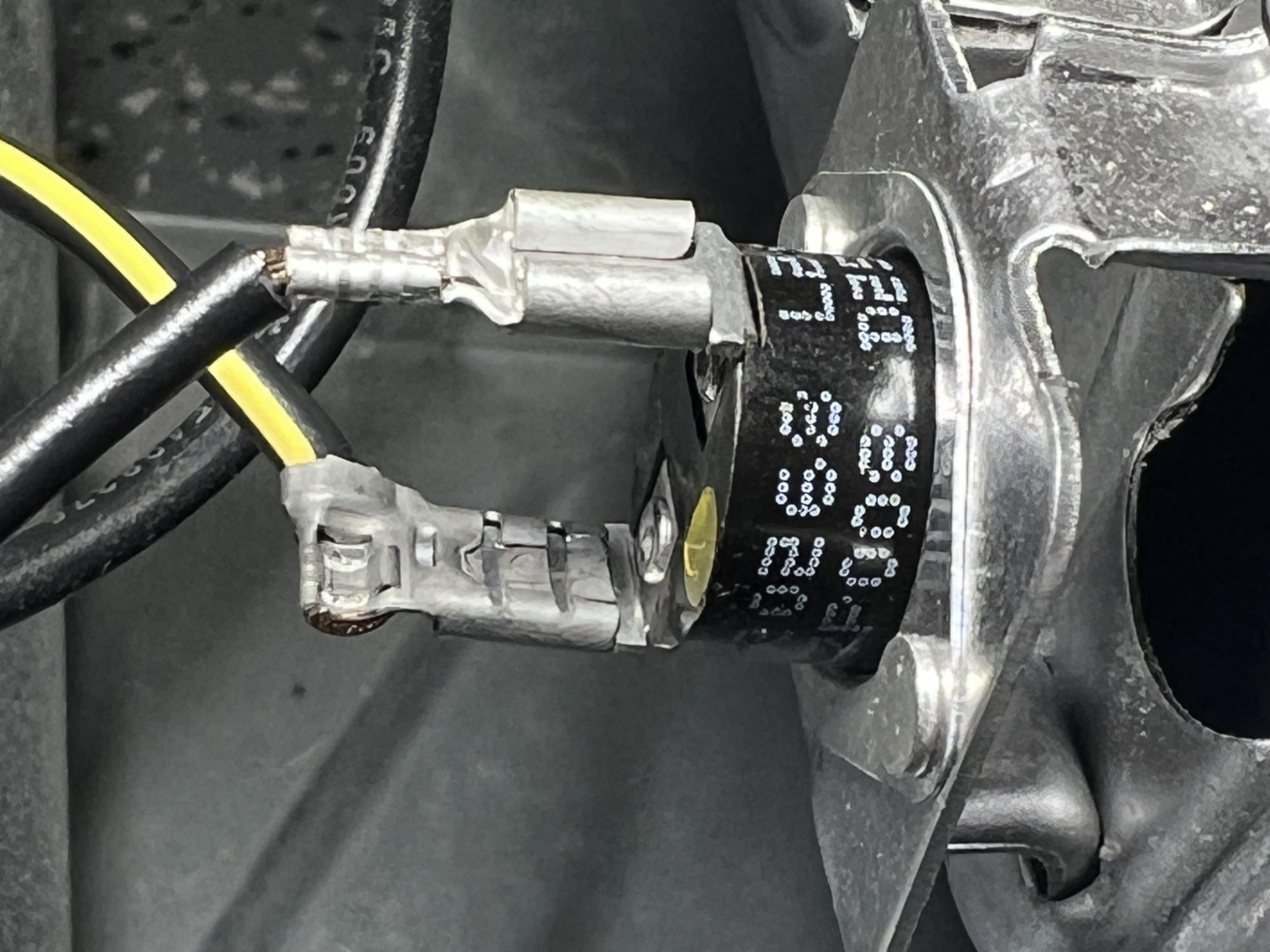

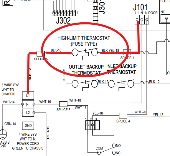

Well, let's start looking. Bust out the skewed-matic and my reader glasses.... Let's see, L1 to board at the J101. Any voltage there? Nope. Hmmm. I see a "High- Limit Thermostat (Fuse Type)", what the heck is that? So I start looking for that fuse. It's not at the back near the terminal block. It's anywhere that I can see. I follow the wires and they go into the cabinet. Crap.... do I have to take this thing apart after I just put it back together. Yup....

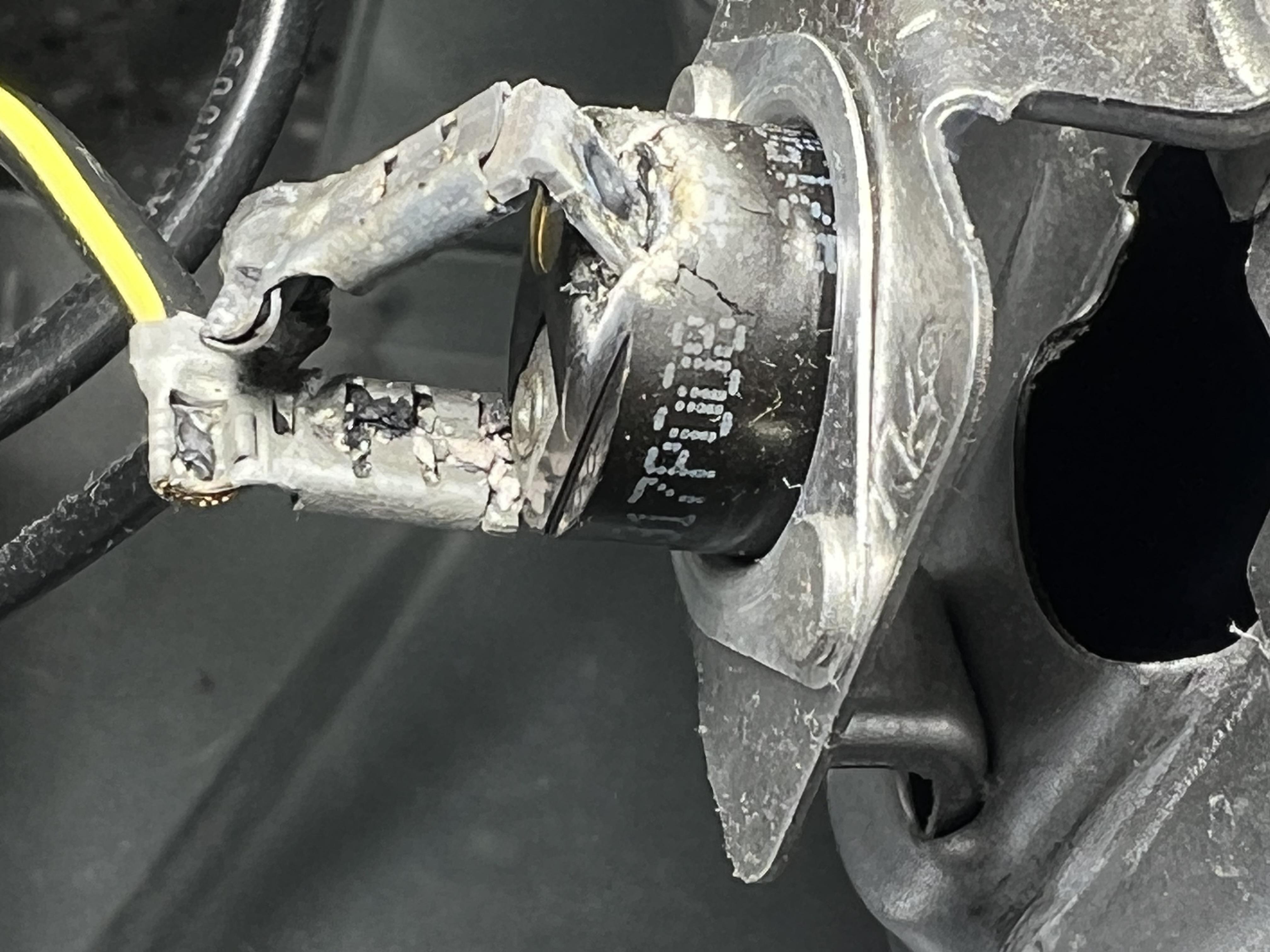

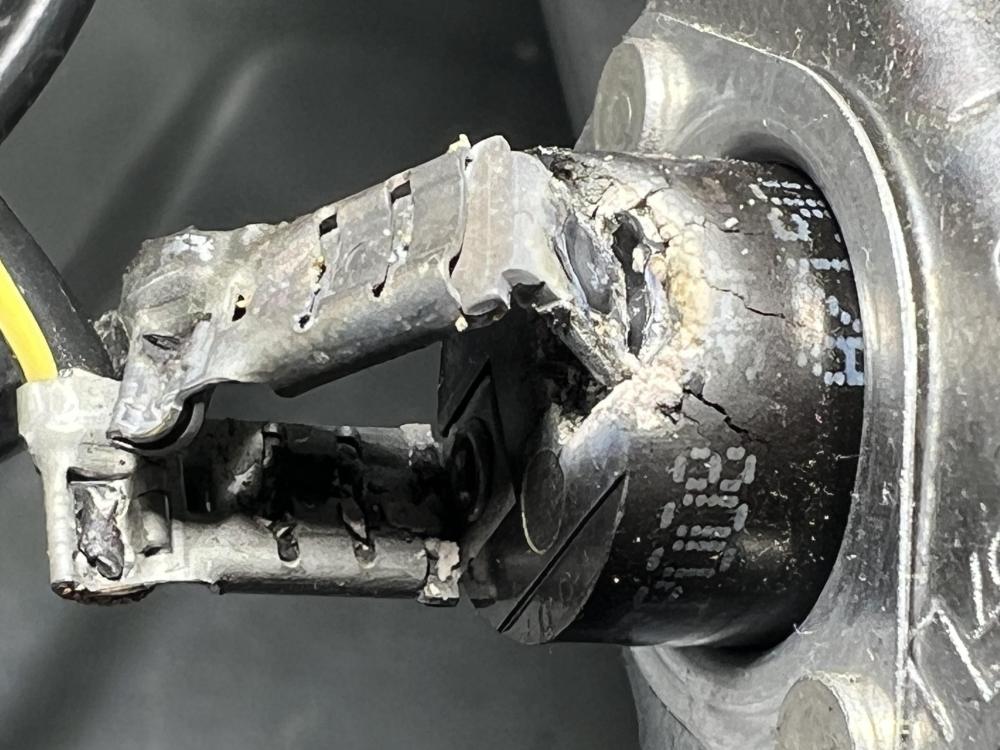

Lo and behold, I find that the aforementioned "High- Limit Thermostat (Fuse Type)" is the dang Thernal Fuse on the heat canister. Huh? First time seeing that. If that thermal fuse opens- it doesn't just kill the heater- it kills power to the board! Lights out homie!
In this case, I found that a terminal on the fuse was charred and not making connection to the biimetal inside. Makes sense now... intermittent working, and finally died. New fuse and new terminal and we back in bidness!

That is some real troubleshooting in action. Shows the troubleshooting insight to be had from reviewing the schematic instead of poking around blindly hoping to get lucky. Luck doesn't get stuff fixed. But systematic troubleshooting using the schematic does. Great post, @Koi Guy!
