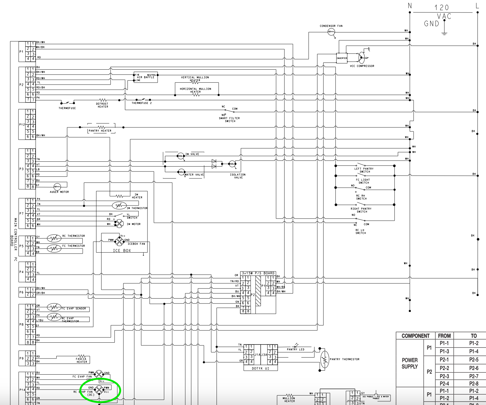

A tech in the Repair forums here at Appliantology was trying to troubleshoot an inop evaporator fan motor, and he had some trouble figuring out what to make of his measurements.
Let's take a look at the schematic in question and see if we can clear up the confusion.
Oh boy, that's a tangled one! I've circled the refrigerator evaporator fan motor in question.
We can tell a few things about this fan immediately. The Vcc and GND designations show that this is a DC fan motor. Vcc is a common label for the DC voltage supply, and Ground is the return for DC power. The wire labelled PWM tells us that this is a BLDC motor with a Pulse-Width Modulated speed signal that it receives from the main control.

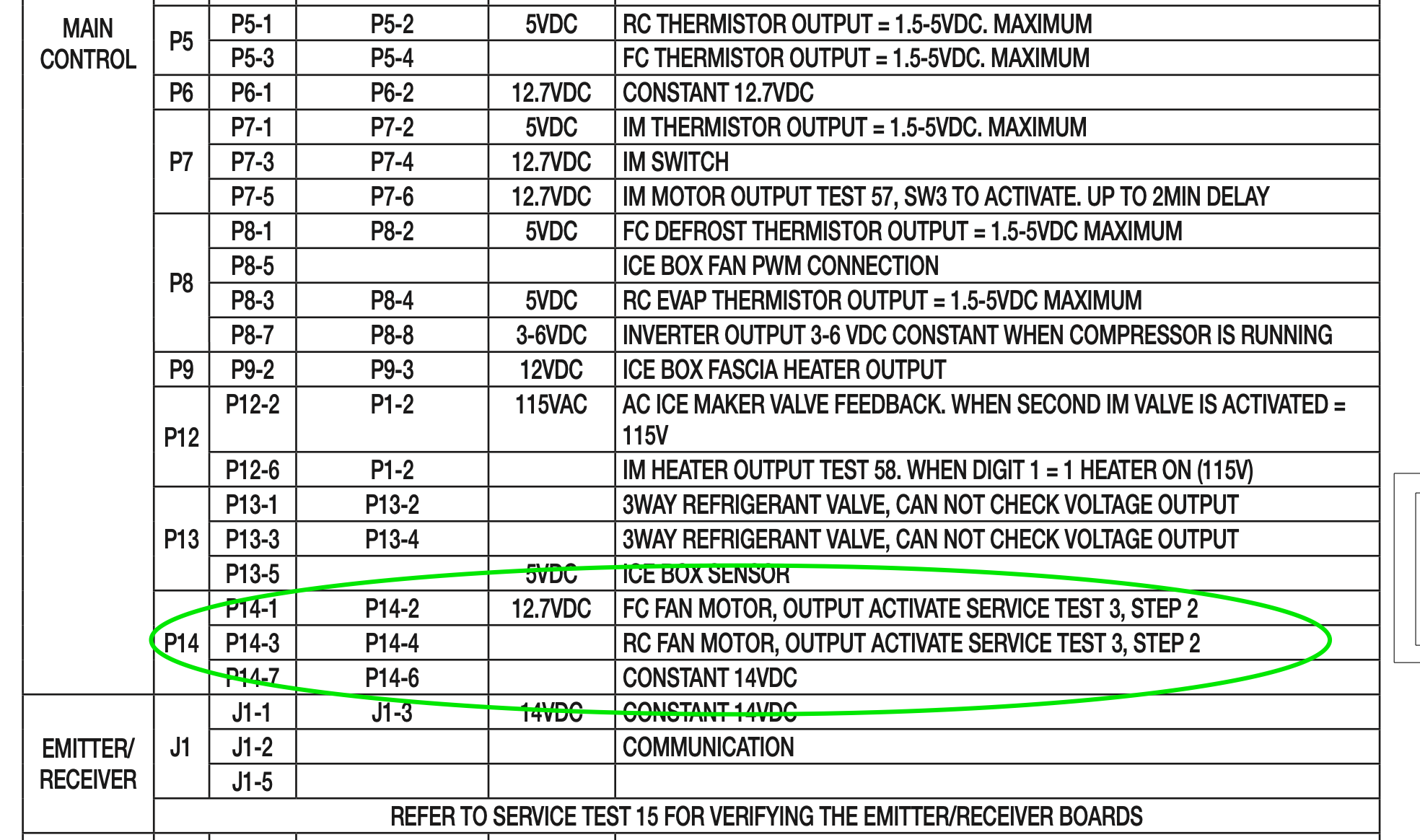

That all seems pretty straightforward, but the wrench gets thrown in when we look at the spec block for the fan:
That's odd -- this spec block seems to be saying that, if you measure at pin 3 of P14 on the main control board, you'll get a stable 12.7 VDC. That's not at all what you expect from a PWM line -- rather, that's what you would expect to see as the voltage supply to the motor. So if you don't get around 12 volts at that line, does that mean you have a bad control board?
PWM signal specs are always given as a range. That's because what your meter measures is the average of the DC square wave signal. So based on our knowledge of how this technology works, I'm suspicious of this spec.

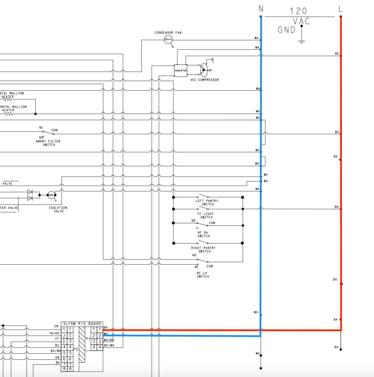

To get to the bottom of this, let's go all the way back to the wall outlet and see how power gets to the RC evaporator fan.
So the first stop is this power supply board. But how do we tell what the board does with this Line and Neutral input?

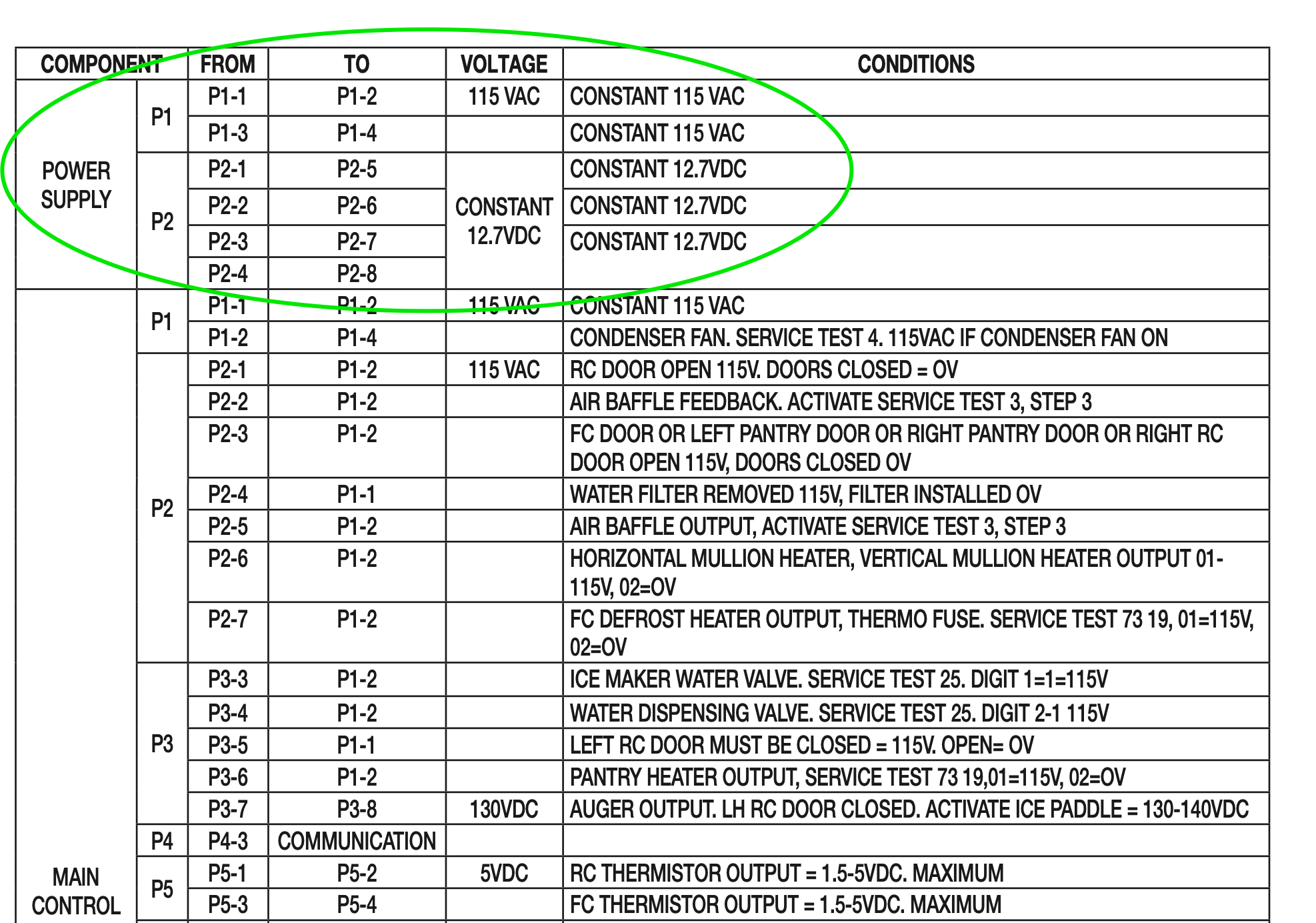

This is where we need to turn to a spec block, which thankfully they give us in this tech sheet.
That makes things pretty simple -- pins 1-4 of P2 on the power supply board are 12.7 VDC, and pins 5-8 are DC Ground.

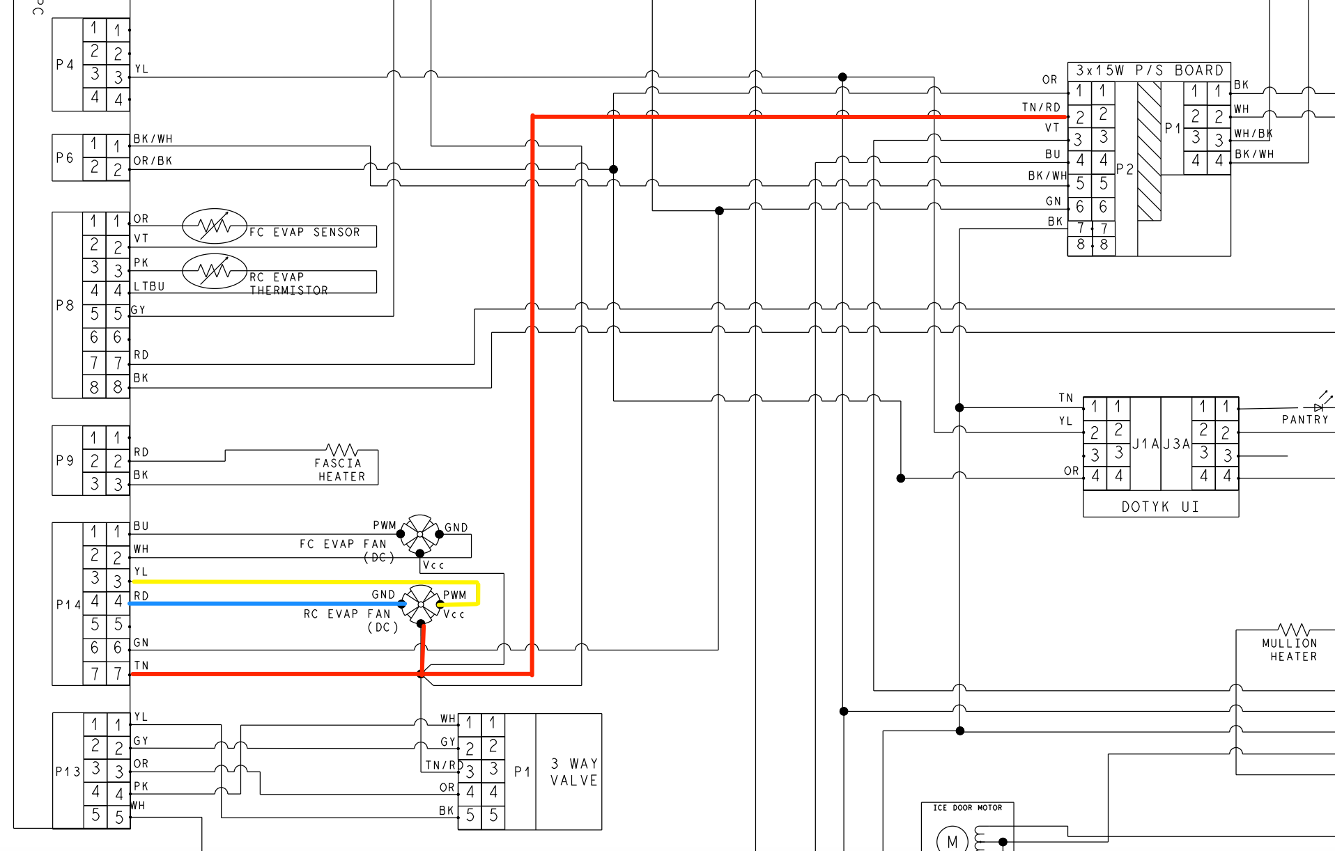

From the power supply board, let's trace the power supply to the RC evaporator fan.
Aha, so we have 12.7 VDC standing at the fan motor on the Vcc pin. That voltage is always present at the fan motor -- we know that because that same line also supplies DC voltage to the main control board.

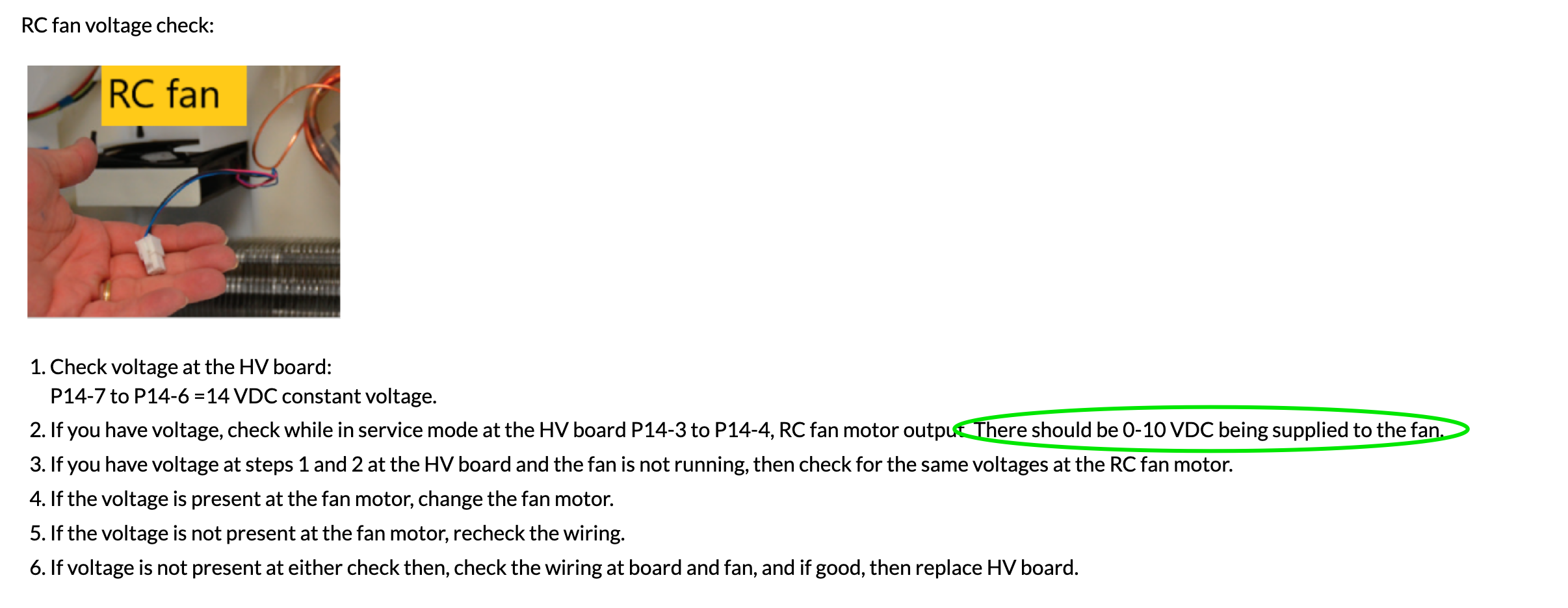

Well, after a bit more digging in a troubleshooting guide supplied by Whirlpool, I found some information that clarified the situation:
That makes much more sense. The PWM signal supplied by the control board is not a steady 12.7 VDC -- it would be somewhere between 0 and 10 VDC. And that's what you would expect for a PWM signal.
After a bit of a journey, we've figured out what voltage readings we should expect at the fan motor: something around 12.7 VDC for the voltage supply, and then something between 0-10 VDC on the PWM line.
