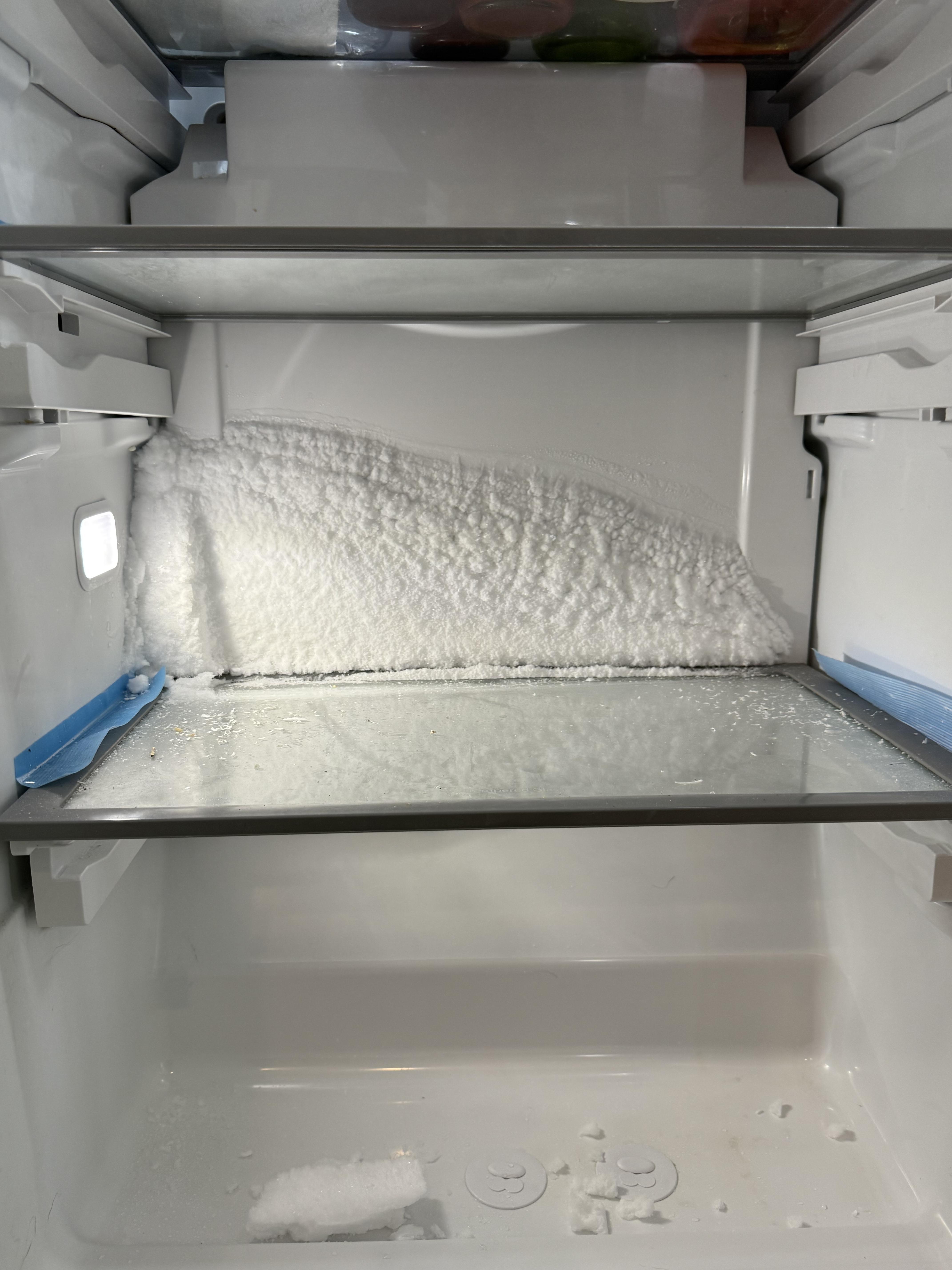

A tech here in the Appliantology forums ran into a Whirlpool dual-evaporator refrigerator with a frozen fresh-food evaporator, and it caused him to ask the following question about troubleshooting it:

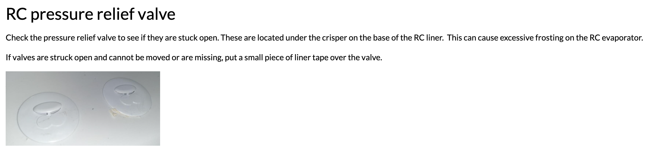

Check for any gaps or leaks in the gaskets and liners. Air infiltration = excess moisture freezing on contact with the evaporator.
One particular place to check is this area:

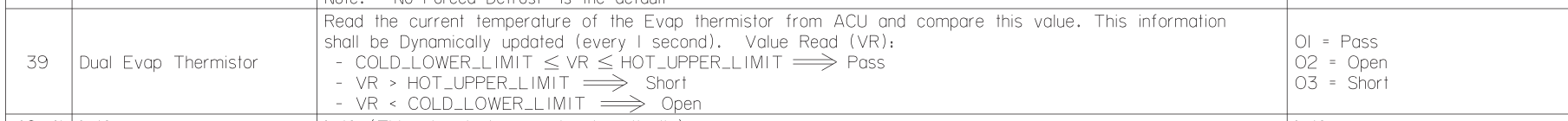

If there are no air leaks, the next order of business is to see if the control is running the air defrost often enough and long enough. Our key player here is the refrigerator compartment evaporator thermistor. If that's out of spec and telling the control that the evaporator is warmer than it actually is, then the control will not run defrost as often as needed.

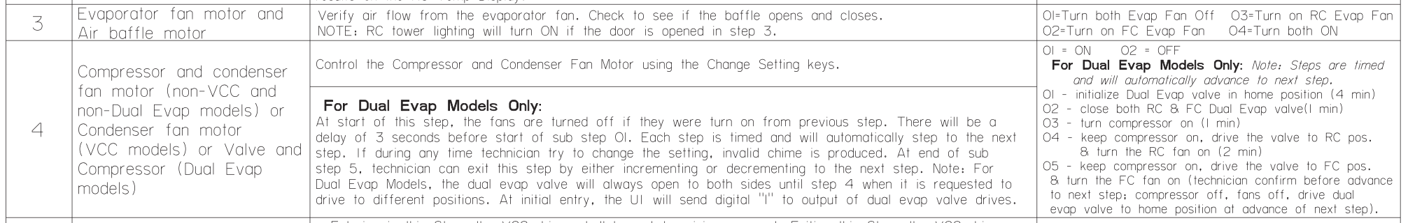

You might think that you could simply run the test for this thermistor in diagnostic mode, as shown here:
But this test only shows you if the thermistor is open or shorted, not if it's out of spec.

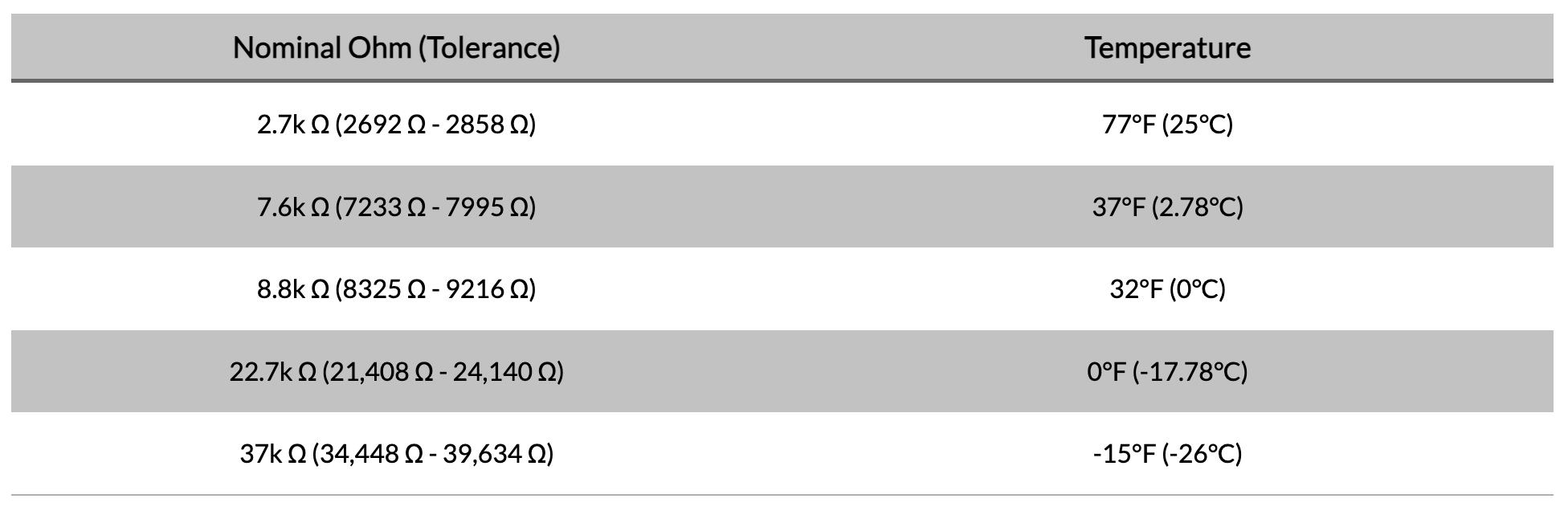

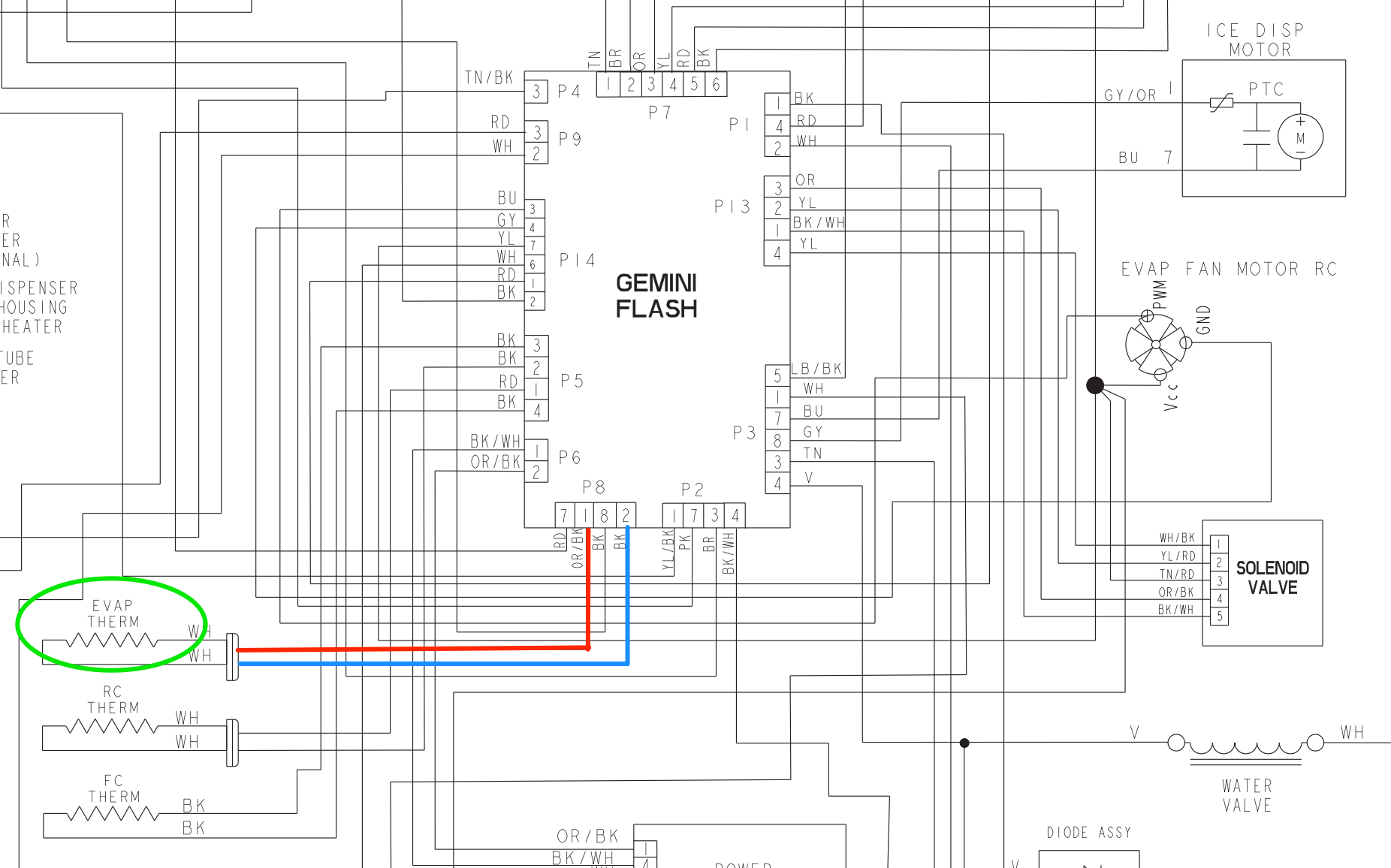

Instead, we should access the control board in the machine compartment and measure the refrigerator evaporator thermistor's resistance.
We would then compare the resistance reading we get across P8 pins 1 and 2 to the chart:
If it's out of spec, you've found the issue.

Next up, we need to check that the evaporator fan is running properly. This can also be done from the control board -- first, initiate test 3 in diagnostic mode to turn on the evaporator fan. If you hear it run, you know it's good.

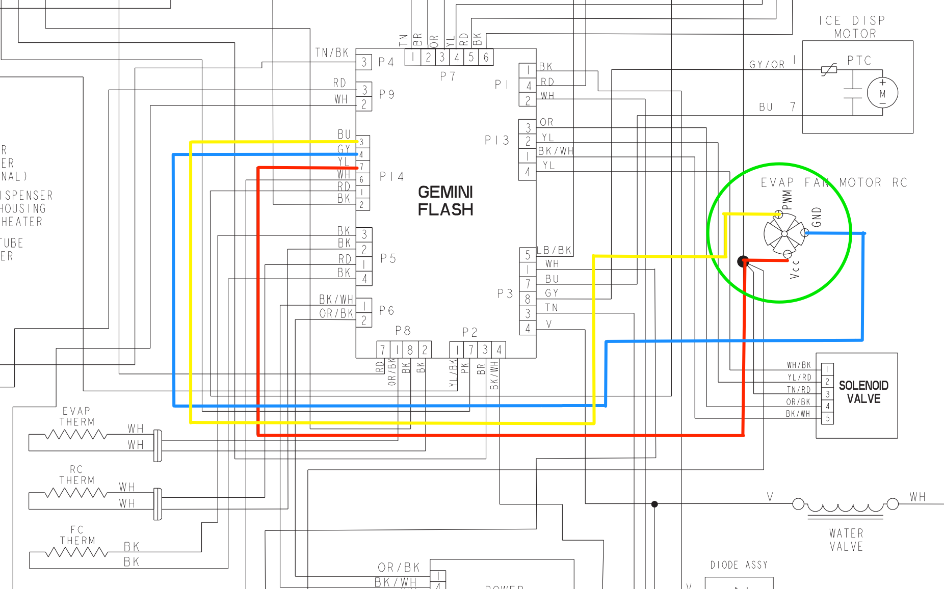

If it doesn't run, check for 14 VDC from P14-7 to P14-4 -- that's the DC voltage supply. If that's good, check for the PWM signal from P14-3 to P14-4 -- that's the speed signal that tells the fan how fast to run. You should measure something between 1 and 10 VDC. You need both of these voltages for the fan to run.

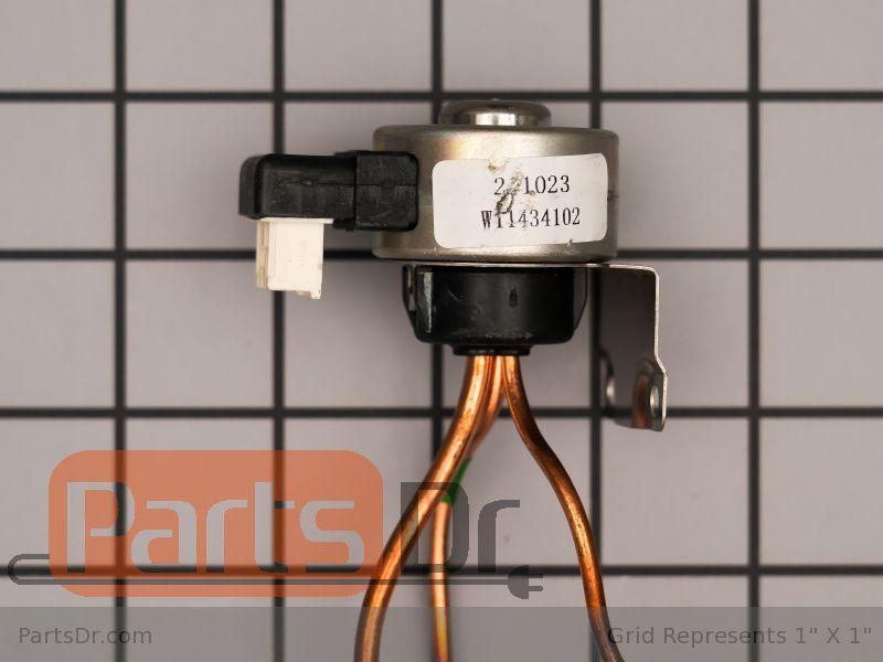

3-Way Valve
Our last step in our half-hour journey will be the 3-way valve. If this is not properly stopping refrigerant from moving through the fresh-food compartment evaporator during defrost, then frost will simply continue to collect.
Our test is pretty simple here: initiate step 4 of the test mode, then put a finger on the body of the 3-way valve (it's also accessible in the machine compartment, just like the control) Every time it changes position, you should feel it vibrate. No vibration = no valve operation.
