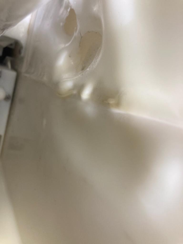

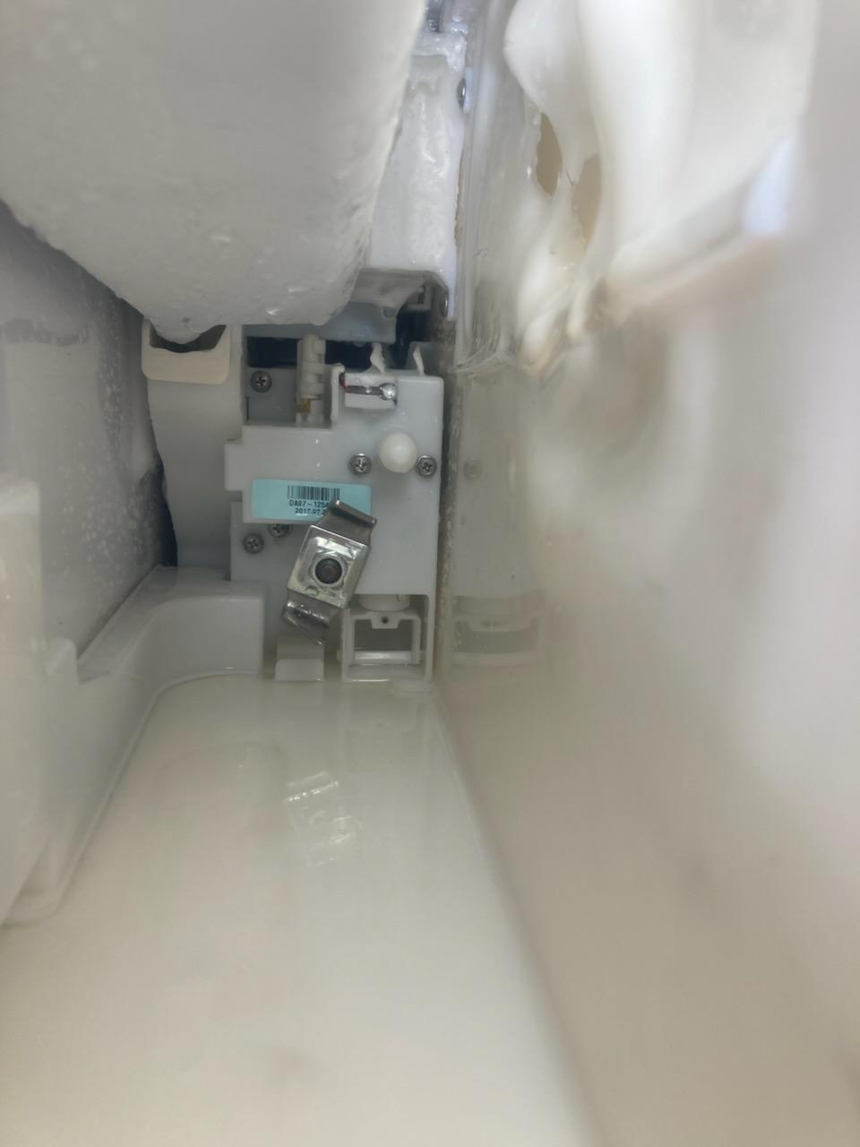

Let's say you get called out to fix an ice maker that has frozen over. You show up at the job, open 'er up, and this is what you see:
Another angle:
What do you think happened here? What could have caused that kind of damage to the walls of this ice box?

Slav
A heat gun trying to defrost?
By the way, the link above is going to a washer problem, not IM.

Coley
Husband using the hair dryer...
I've had a few Samsung icemakers that were dang near impossible to remove from hubby taking matters into his own hands.
