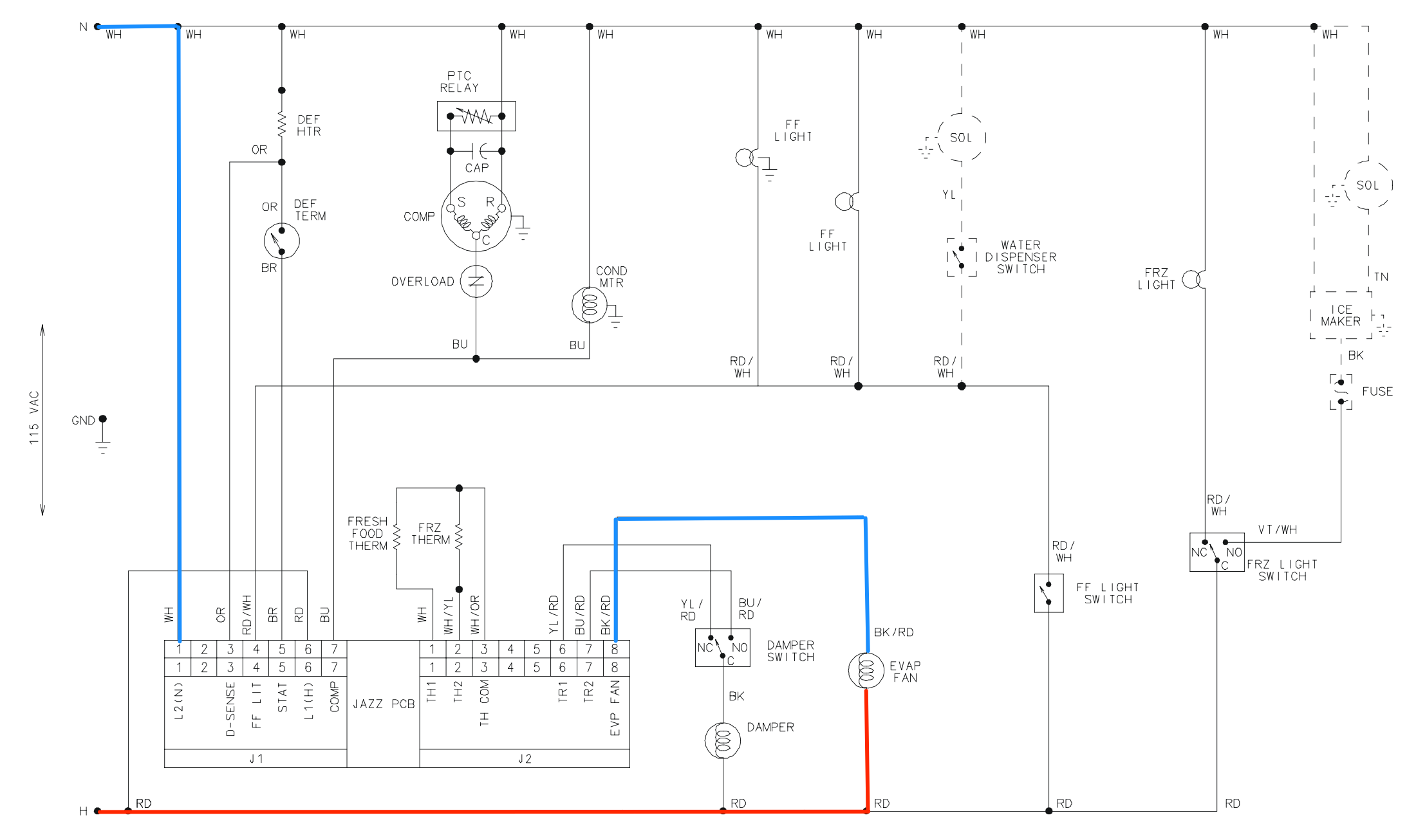

The first thing we wanted to figure out was if the evaporator fan was getting a good power supply. So before we even do any tests, let's figure out how the fan's circuit works.
This markup shows how the evaporator fan circuit is supposed to work. Line voltage is standing on the fan at all times. The control board simply switches neutral to complete the circuit. You can think of it simply as a switch that connects neutral at J1-1 to J2-8.
With this in mind, the test we want to make from the board is pretty simple: we'll just set the control to run the fan in test mode and then take a voltage measurement from J1-1 to J2-8. If we get a reading of 120 VAC, then we know that the board is not closing the switch to supply neutral.

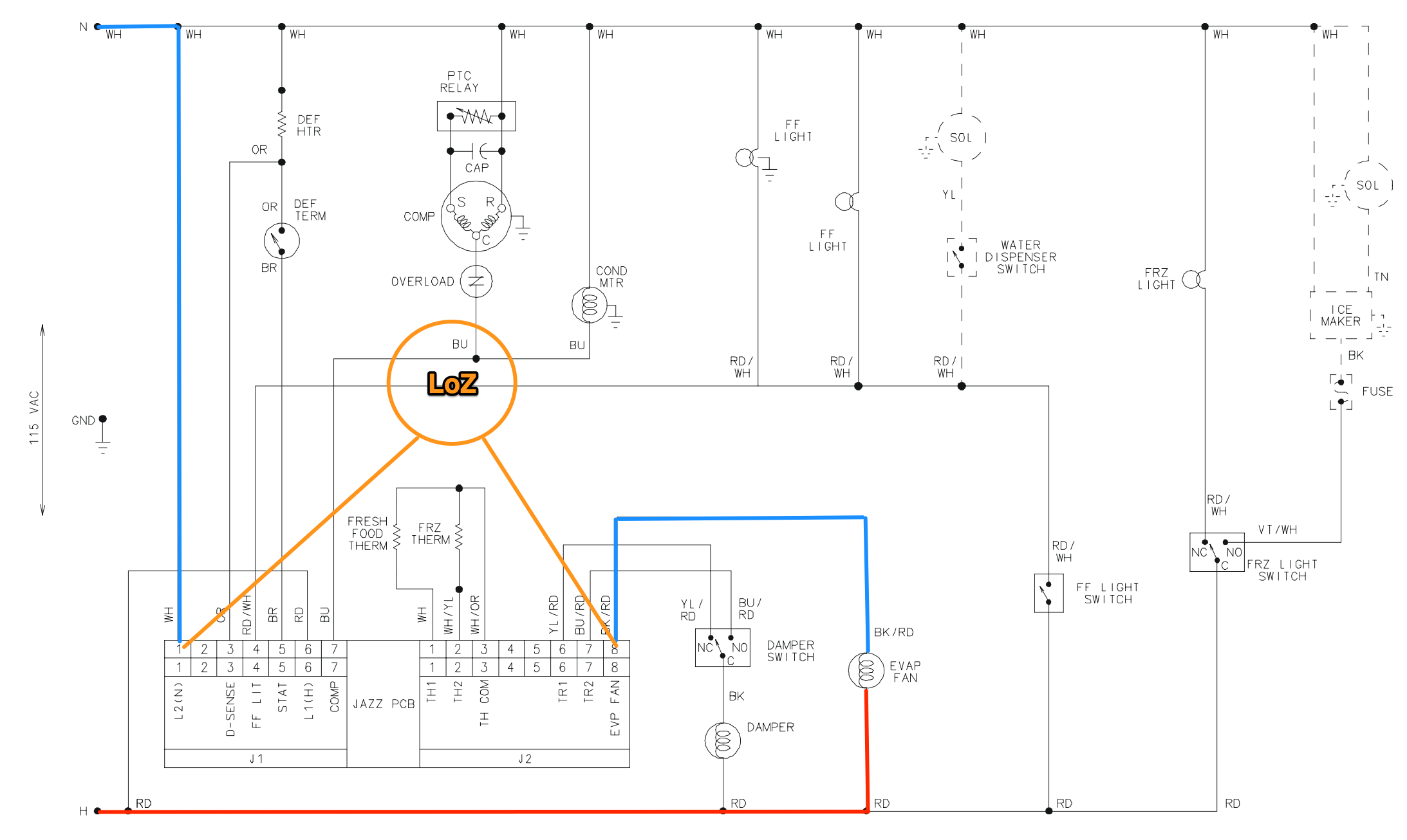

So, we set our meter to LoZ (as you should when testing an AC load) like so:
And we measure... 60 volts??
What's even weirder than the voltage reading, the fan motor starts trying to run. It doesn't run full out -- more like an odd, pulsing, low-speed run. As soon as we take the probes off, the fan stops running.
What gives? Have we smoked the board? Is the board somehow responding to our measurement and running the fan?

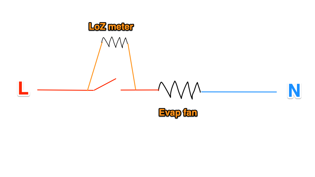

So what does this mean for our circuit? Well, to see what's going on here, let's redraw our circuit in a simpler form:
This is functionally the same circuit. We have just replaced the control board with a switch, since that's the purpose the board is serving in this circuit.
We can now see more easily what's going on here. We unintentionally created a load in series with the evaporator fan. This load in series is our loading meter, which bypasses the control board switch.
Since the evaporator fan has a resistance of a few thousand ohms, around the same as our loading meter's resistance, the circuit voltage is roughly split in half between them. This is why the loading meter is only showing around 60 volts -- that's the voltage being dropped across the meter. And the evaporator fan isn't running properly because it's not getting the full circuit voltage.
Now that we understand what's happening, we know how to interpret our measurement: clearly, the evaporator fan is fine, and the issue is that the control board is not providing neutral to the fan in service mode. A new control board, and it's good as new.
