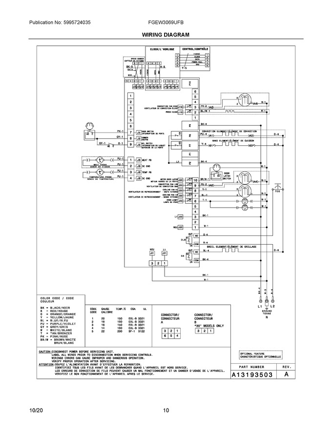

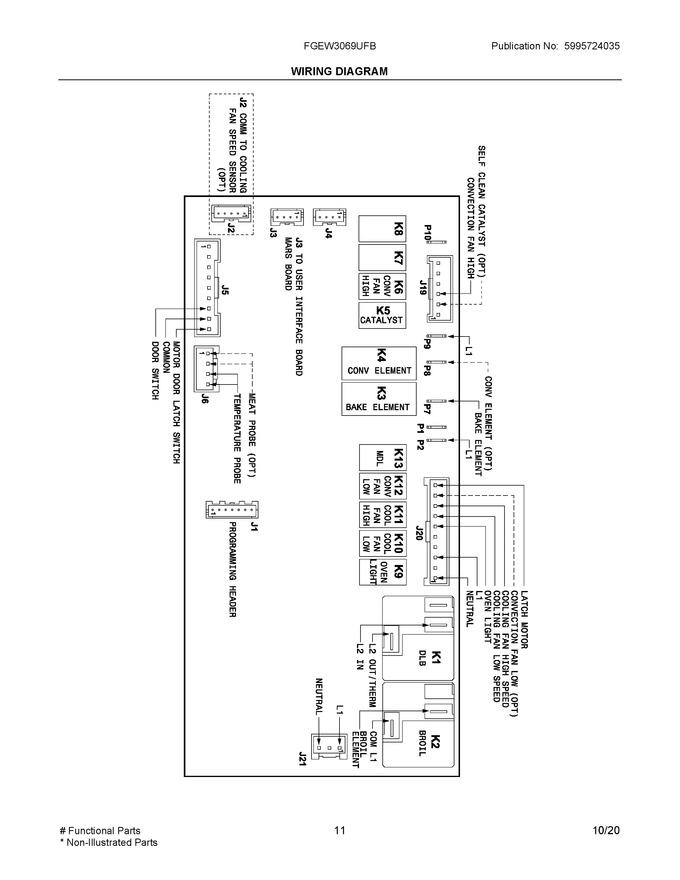

Per my comment, I've attached the schematic of the Frigidaire wall oven I was working on.
Jo - Denny's Appliance
@kjolorenzen I need a PDF of the tech sheet so I can have good quality images to screen share. If you have that, please send it to me. If not, post a request so Sam can upload it for you.
Also, what's the problem statement on this one?
Anyone else have something they want to talk about: I need a PDF of the tech sheet and a problem statement.

Well, heck, I thought it did upload as a PDF.  Problem statement is "Customer indicates error code F045 showing on screen, indicating a cooling fan error. When turning on preheat, oven will start preheat, and then will shut off about 2 minutes into heat with that error code on screen."  I've sent the PDF to the contact portal.
