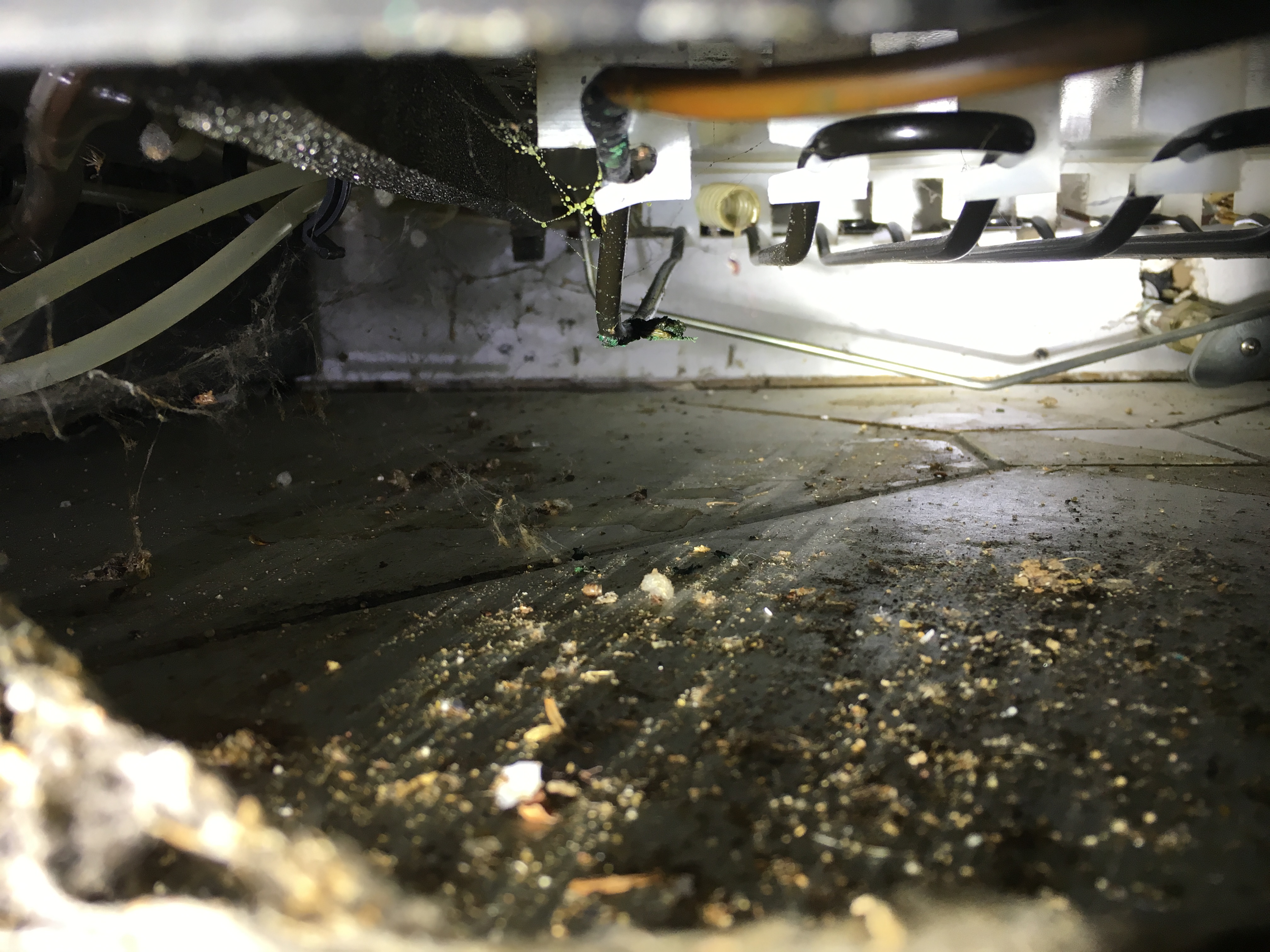

Sub Zero Water intrusion
Hole in the hot gas loop causes water to get into the sealed system. Only solution is a complete sealed system change out except the condenser and in cabinet tubing but those need to be flushed with RX11 or another system flush then nitrogen.
Sub Zero water intrusion damage
