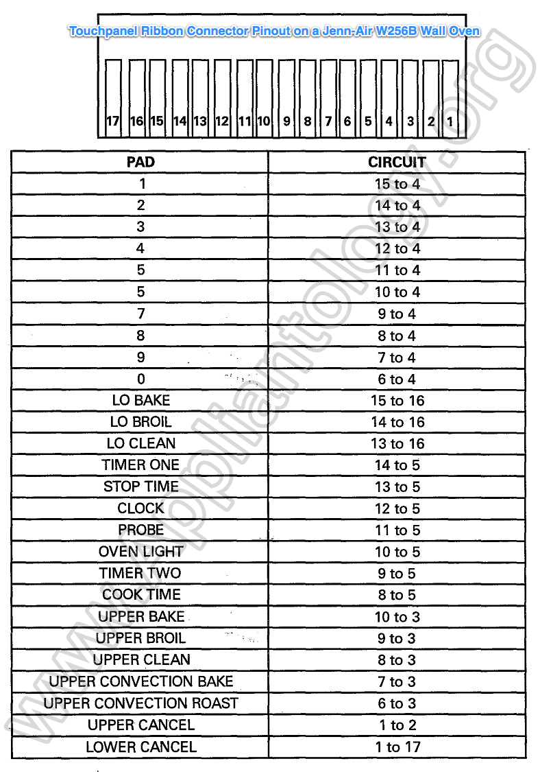

Touchpanel Ribbon Connector Pinout On A Jenn Air W256B Wall Oven
Use this to check the continuity of the individual keypads in the touchpanel when the oven control is beeping constantly and driving you crazy. A keypad should have continuity only when it is pressed. If it has ontinuity when not pressed, it's shorted and will make the crazy beeping noise.
