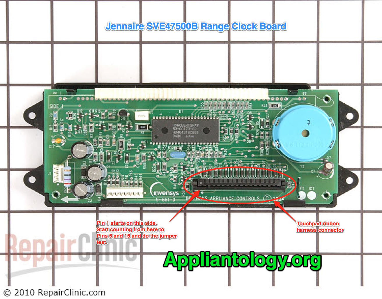

Jenn-Air SVE47500B range clock board esoteric repair kata
This pic illustrates an esoteric repair kata from Sublime Master Trying to help posted in this topic. The problem is that the later touchpads manufactured for these ranges omitted a crucial jumper wire which makes the control think the touchpad is disconnected even when it's not.
