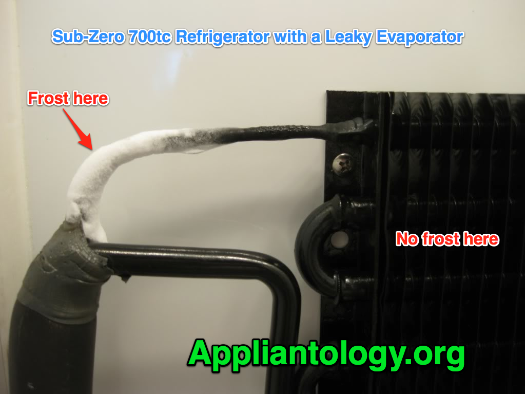

Sub Zero 700tc Refrigerator with A Leaky Evaporator
Rash of these problems on the 600 and 700 SubZero models. Call SZ and see what they'll do for you.

I had the same issue on my 8yr old 650, called SZ and told them it was common knowledge that this is a problem, they covered the new evaporator and 1/2 the labor. I also had sent a snapshot to the repairman to make sure he had the part BEFORE he came that saved me the $125 diagnostic fee.
