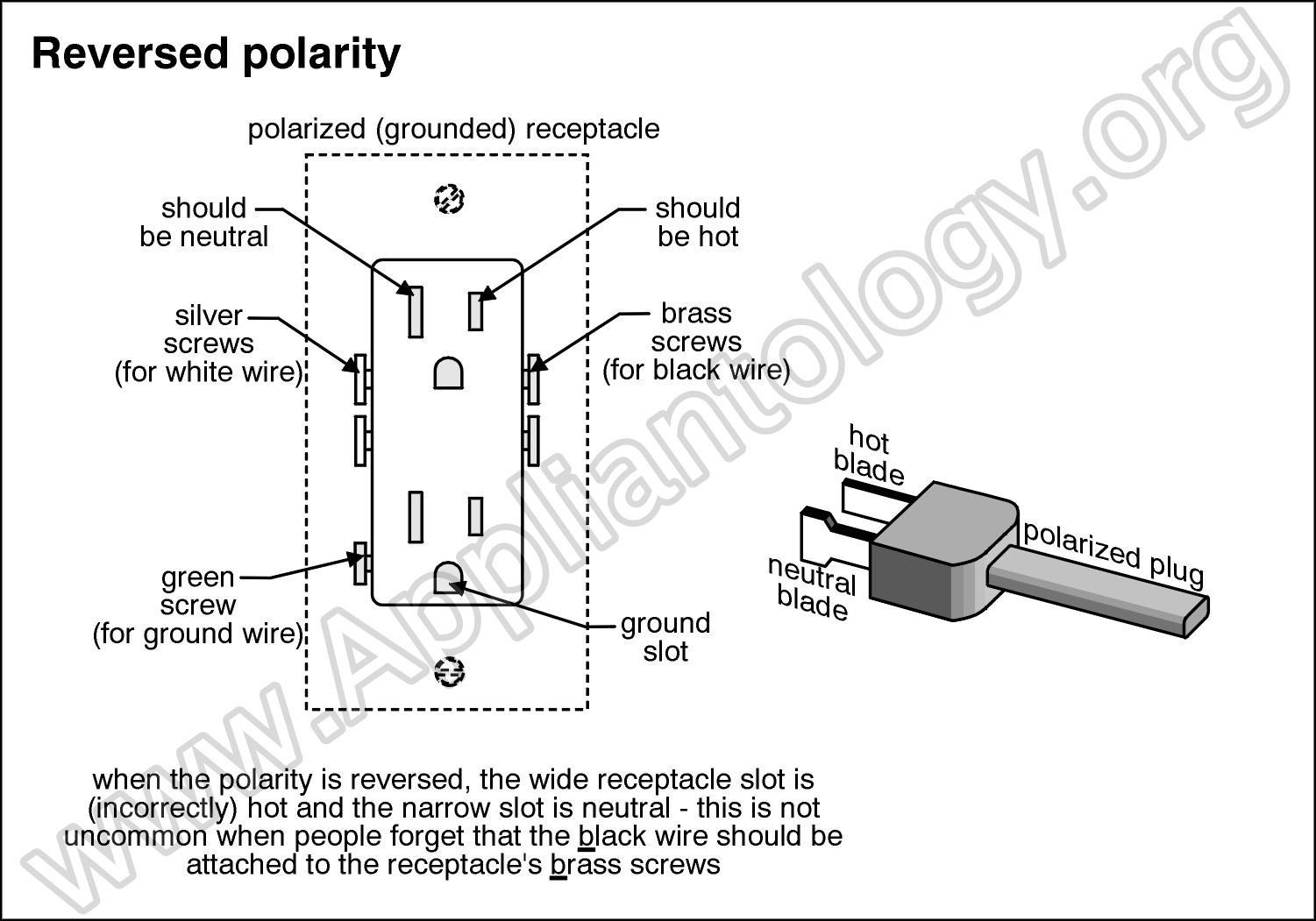

How To Check Electrical Outlet Polarity
Correct outlet polarity is critical to the proper functioning of gas stove burner spark modules. Reverse outlet polarity is a common cause for the continuous sparking after the burner is lit.
