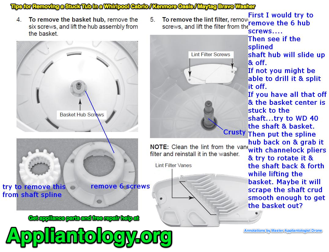

Tips for Removing a Stuck Tub in a Whirlpool Cabrio / Kenmore Oasis / Maytag Bravo Washer

You could also try Cabrio Tub Removal Tool from Jays Appliance
