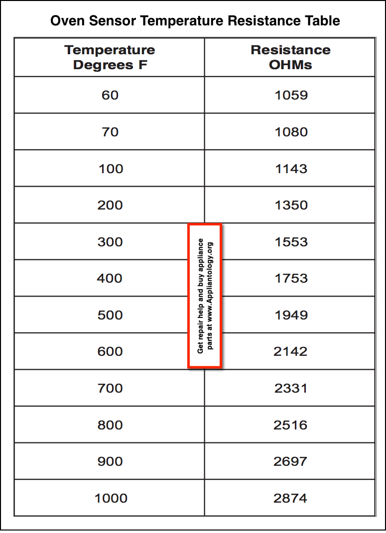

Oven Sensor Temperature Resistance Table
Use this table to test the sensor in your oven. You need at least two and preferably three resistance measurements at different temperatures to determine if a sensor is good or not. Check the sensor resistance at room temperature only is not sufficient to conclusively prove that the sensor is good because it may have a non-linear response at higher temperatures.
