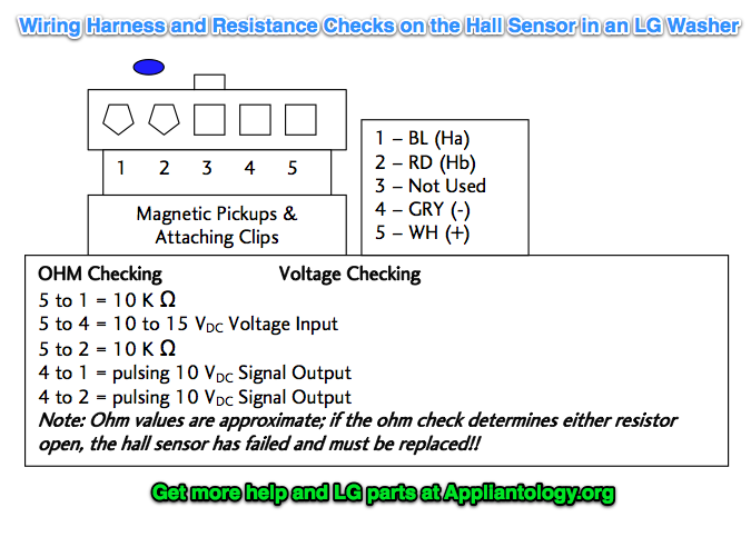

Wiring Harness And Resistance Checks On The Hall Sensor In An LG Washer

Checks can be made at board or by taking off the rear cover. There are connectors down in the back left corner. Besure to reinstall the plastic guard so water doesn't do it's damage to the connections.
