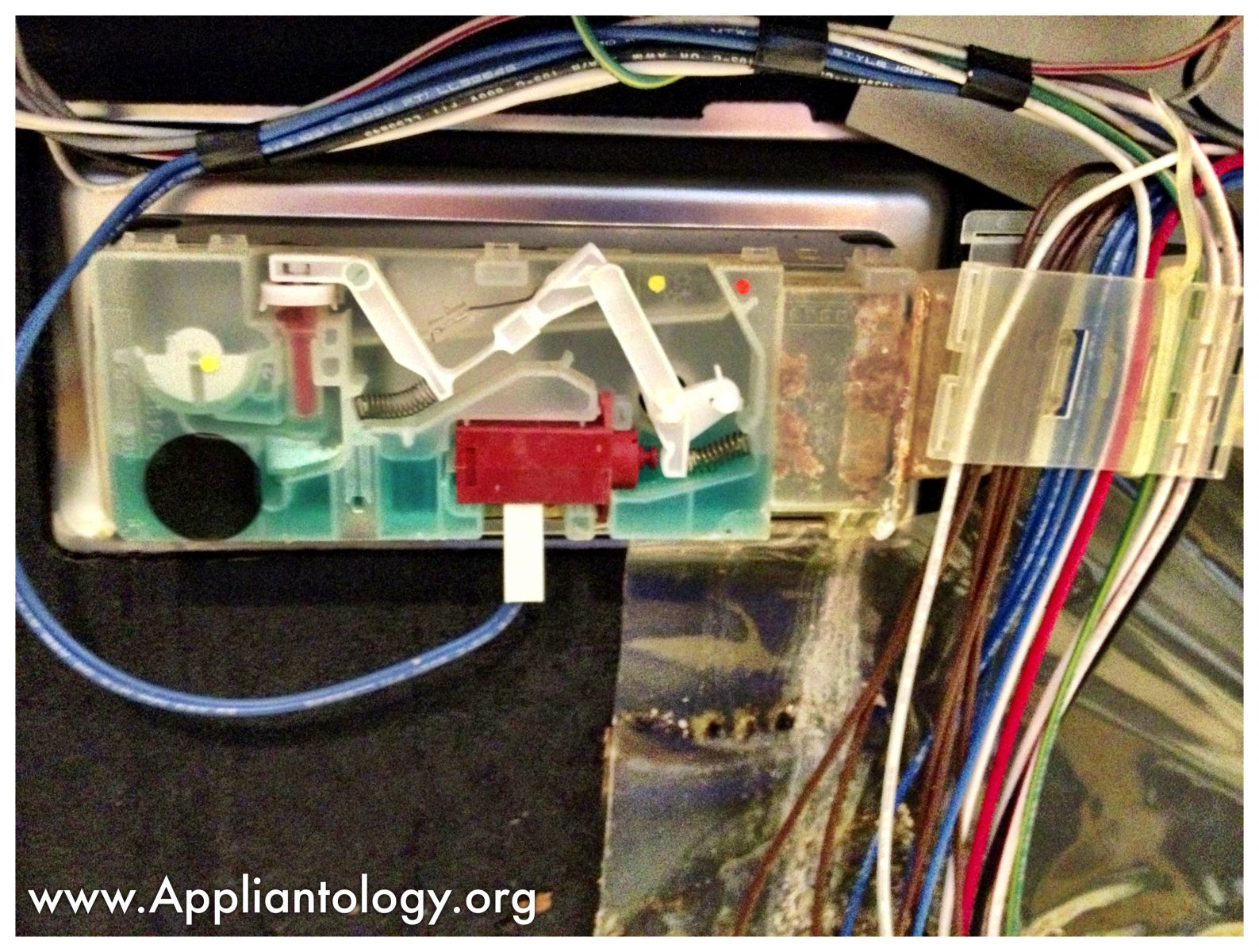

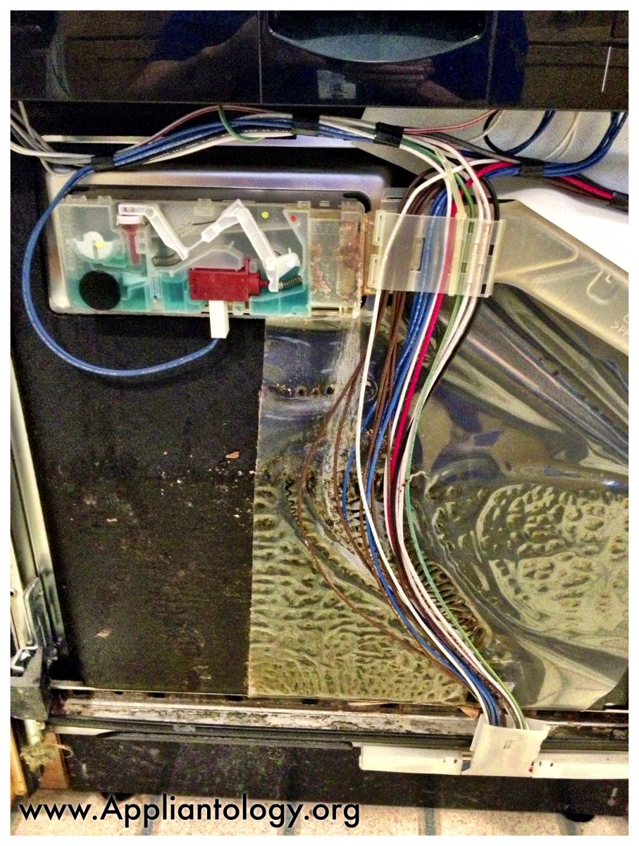

Outer door panel removed. Notice the white stain streaking from the dispenser. If you see this, you need to replace the dispenser before the rinse aid vapors take out the circuit board. Buy the new dispenser here: http://www.repairclinic.com/Bosch-Dishwasher-Dispenser-Parts?RCAID=24038
