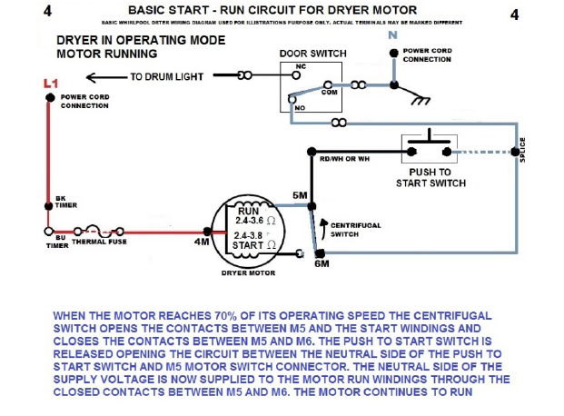

Dryer motor start and run explained. The motor switch also has a contact on it that brings in L2 the second line of the heater element to provide the 220 vac for the heater.
