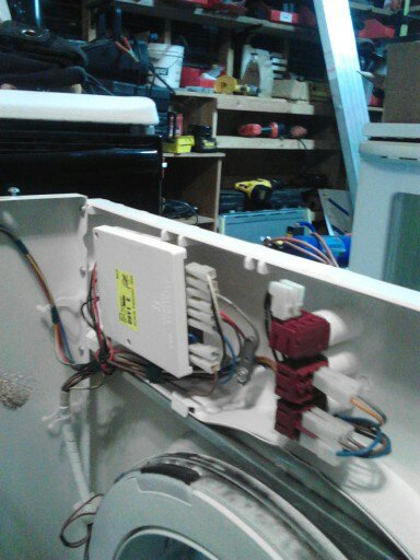

three seperate buttons, the bottom one is for the power, There is 220 vac on this power switch, be sure to disconnect all power. Be sure all grounds are put back on. This was the reason this unit would not run, the power button will not stay fully in making both switch terminals.
The liggth on the front will Flash when power is applied to unit. Hitting start button light will go steady.
The power button cost abot 110,00 to replace and is not easy to get out. Little hole and you have to depress two tabs be careful
LEW005PQ dryer,

These new switches come with crazy glue some times
