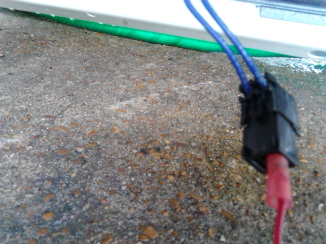

cabrio pump harness IMG 20131019 153817.018
This plug looks like the wire is good and connected, its not. there are basically four push in knife type connectors that ars suppose to strip the wire and make the connection. often it cuts the wire and eventually breaks. i reused it once, had it come back in a month, used regular insulated terminals to replace it.
