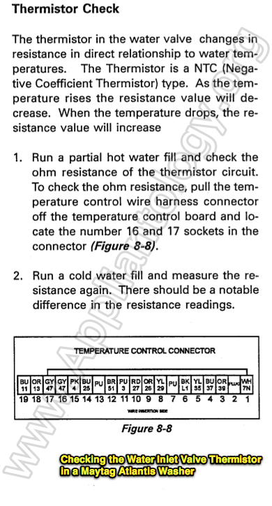

Checking The Water Inlet Valve Thermistor In A Maytag Atlantis Washer
Sign in to follow this
If the thermistor is bad according to this test, then buy the replacement water inlet valve here ==> Water Inlet Valve
