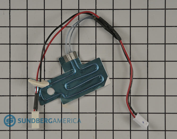

There is a fill tube heater in/on the ice room box.  Maybe it was displaced or wasn't plugged back in?  Correct temperature in all compartments is critical for ice maker operation.
Thanks.  I did make sure I plugged this back in.  Isn't the purpose of that heater to quick heat the ice tray to enable ice harvest?  Would that have any effect on the tube freezing?
There is a piece of foil tape that has a little heater in it that is used to prevent the fill tube from freezing.
Icemaker Fill Tube Heater
The ice maker itself will have a separate heater for releasing the ice and then there may be a 3rd heater on the front fascia where the ice falls out the little door

I don't see a resistance spec for the heater but in service test 19 it should receive 120 VAC

With still no luck, I replaced the tube heater as I noticed the tube was freezing

Thanks for the tip.  Power cycle must have reset the cycle for the tube heater.  Working great now.  I guess I replaced a valve and heater unnecessarily, but glad to solve this.  I never powered down the fridge doing any of the troubleshooting after the ice maker was replaced.  Thanks again for all the help!
