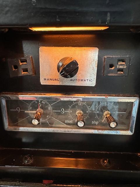

Also just thought of one other possibility - Does this unit by any chance have a clock with the cook START/STOP times, if so it might just be in a timed bake mode instead of manual bake and if you don't reset it to manual bake correctly no mater what you do you won't get the oven to work.

I have no idea if you have a selector switch for oven BAKE/BROIL/OFF/TIMED BAKE or if just the clock for manual and timed bake and BROIL/BAKE options all in the oven t-stat.
If just BAKE/BROIL on oven t-stat and no switch to select options then timed bake would be completely thru the clock controls and you would again need the wiring diagram to know what to check to see if it is correct.
Maybe a picture of the control console area with all controls and the clock to help to see if you have it set correctly.

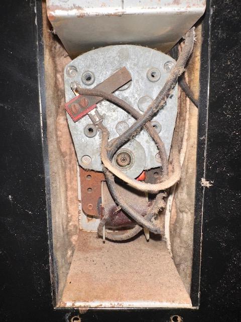

Well I hired Sears Home Services to review my stove.  Unfortunately, the service technician admitted this was out of his scope of work to offer assistance or help.  So I am coming back to ask for other advice.  I am including a picture with hopes you might identify for me.  Is this the gas valve?  I have also included a picture of the selections of the clock/timer/etc.  I have a relative who is very knowledgeable in electronics who may be able to help trouble shoot but without a schematic, I suspect it will be difficult.  Any advice is appreciated.
Does anyone know where I can find a schematic of my oven, that would be a tremendous help.
