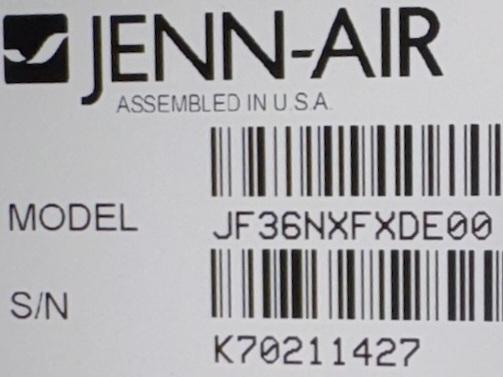

Posted (edited)
Manufacturer: Whirlpool
Model Number: JF36NXFXDE00
Does anyone have access to these technical documents: tech sheet, service manual, and service bulletins related to no power, no cooling, dead console, no fans, no operation, etc. I'm not talking about the single point led lighting issue.
