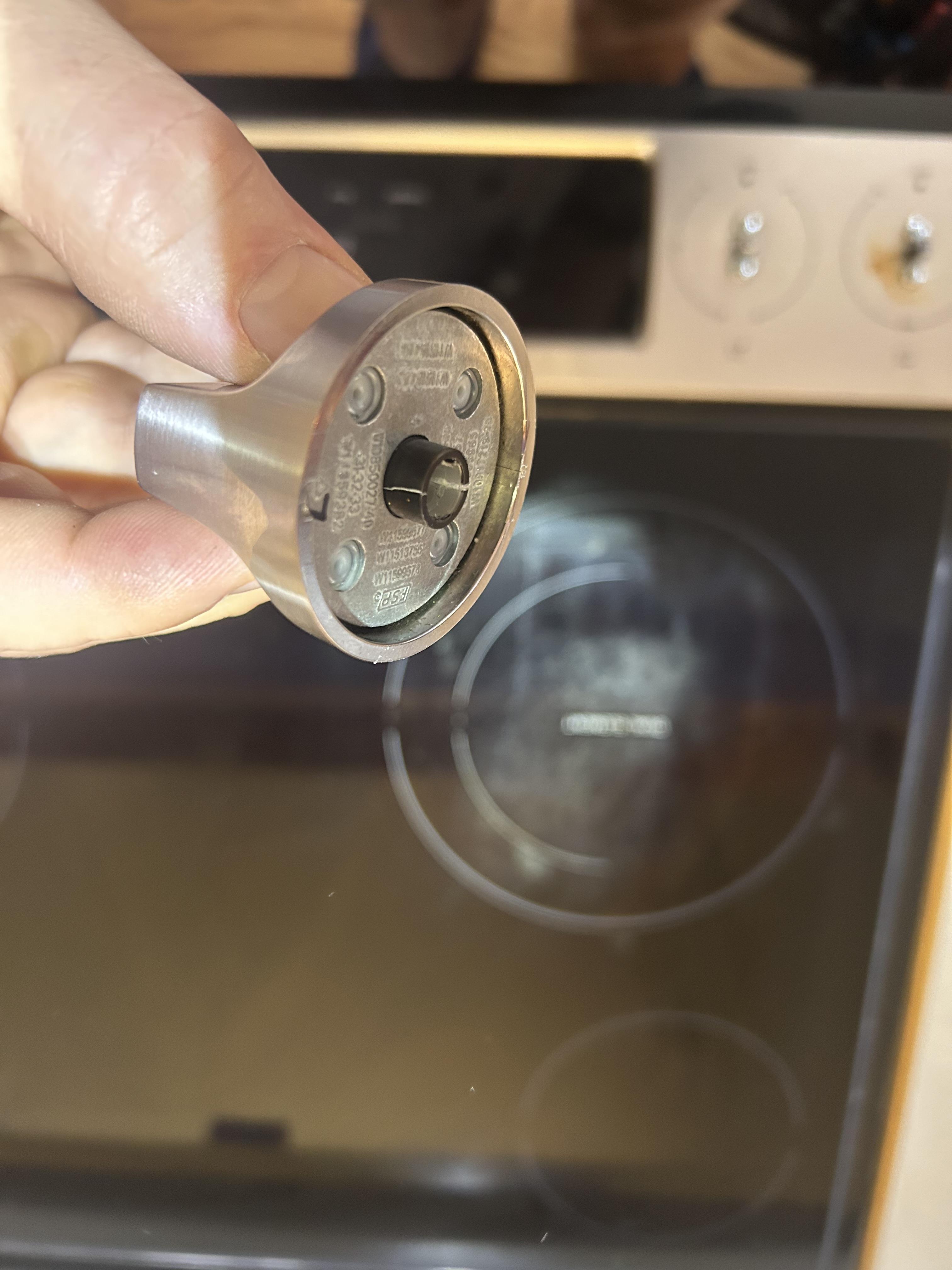

Oddball customer complaint was 3 cooktop burners not working. Turns out she had bad control knobs. Ten second diagnostic. We over prepared for this job!
